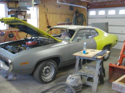

i located a set of 15x7 cop wheels and center caps for $200. good deal i think!
Here's a pic:

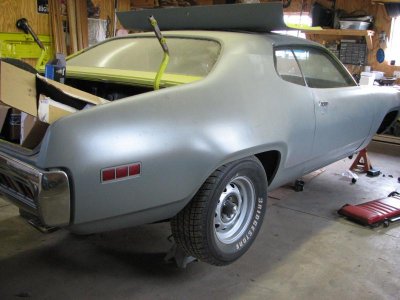

Not a real clear one - but this is all I have right now.
IMHO..the wider front tires look better than the 215's
A 275-60 really should be mounted on an 8" wheel. I've run them on 7's before but in order to get even tire wear, I had to run them with lower PSI and then they didn't handle as well as if they were on an 8" wheel. Inflate them to where they should be and you end up riding more on the center of the tread. Measure the width of the tread and they should be around 9" wide and the wheel should never be more than 1" difference either way. When I finally got 8" wheels, I could really feel the difference and it was much better.
