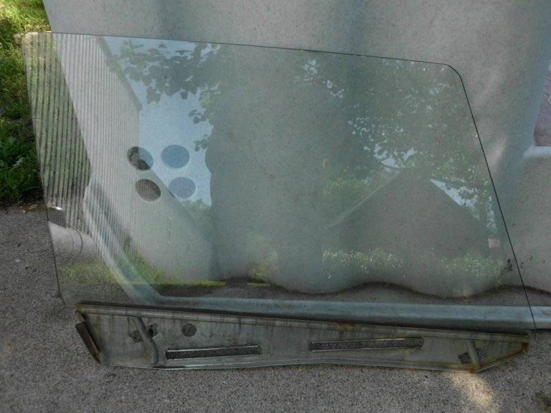

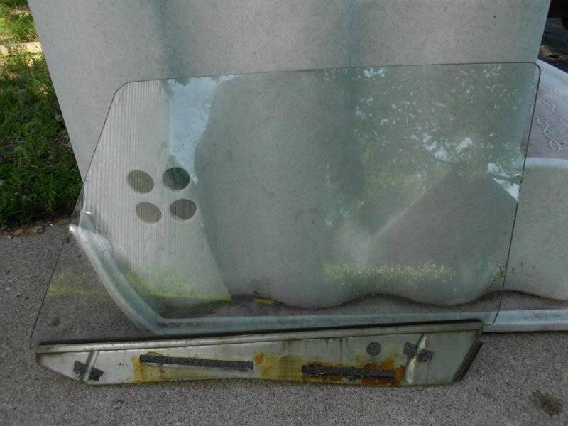

I have the drivers glass in the door. I need the passenger side glass. Can a glass shop cut/make me door glass for my passenger side window? Will it be right?

You'd need to find a shop with the patterns. Don't have a good feel for how common that is out your way.
I have a good used passenger door glass, with the lower framework still attached and in good shape. The downside is shipping, which I'd guess would be $40-45 because of weight and size. I'd sell you the glass for $30. I don't know that you could get one cut for $75 but could be wrong.
Yeah, I was thinking of letting a glass shop use the driver window for the pattern but I would buy yours. Does it have the original marking on it down near the vent window area? You will see it with the window all the way up. Any pics of window/ I can give you e-mail address if you want or post here. Would you ship it Greyhound possibly? My zip would be 17365 to the house and Harrisburg, PA would be the Greyhound terminal. Let me know
No glass mfr marks on this one that I can see. Measures about 22 3/4" across the top, starting at the 'notch' in the front, and about 29" near the bottom.
Greyhound is about an hour drive one way for me. Last time I went there at a buyer's request it turned out to be almost $30 more than USPS. That was a 16" motorcycle rim with tire mounted. I've tended to only use them for items too big to ship by USPS.

View attachment 629569 View attachment 629570
My driver side has the logo on it. The logo from the 50's and early 60's in the front corner of the glass. Not the pentastar logo. Is this original glass?
As you can imagine, I've no idea of the history on the car the glass came from. It appears to have been well cut as the edges are nicely rounded and consistent. Certainly if you went to a glass shop you'd not have the logo in place.
I was wrong about the location of the Mfr markings. If there are Chrysler markings on the glass it is located right above where the outside door handle is. Not down by the vent wing window where I was saying before. Can you get me a ship quote to me my zip is 17365
30 x 26 x 5 box weighing 15 1/2 pds comes in at $37.91 USPS ground (1 week) or $44.05 priority mail (2 day). It's a good solid box with plenty of bubble wrap.
