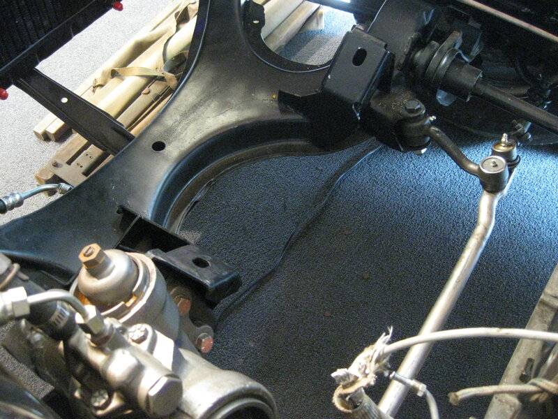

Here's what I did in my '64 as if anyone asked... haha
I used a 1970 K member for two reasons. Improved idler arm setup, and improved sway bar setup. Since the '70 K member moves the engine back (and causes a mountain of problems) I cut the perches off, then put the member in the car. I bolted the perches to the motor mounts and installed the engine with the mounts and perches attached. This put the motor in the stock location on top of the K member. I tack welded the perches in place, pulled the motor back out, then welded them back onto the K member.
