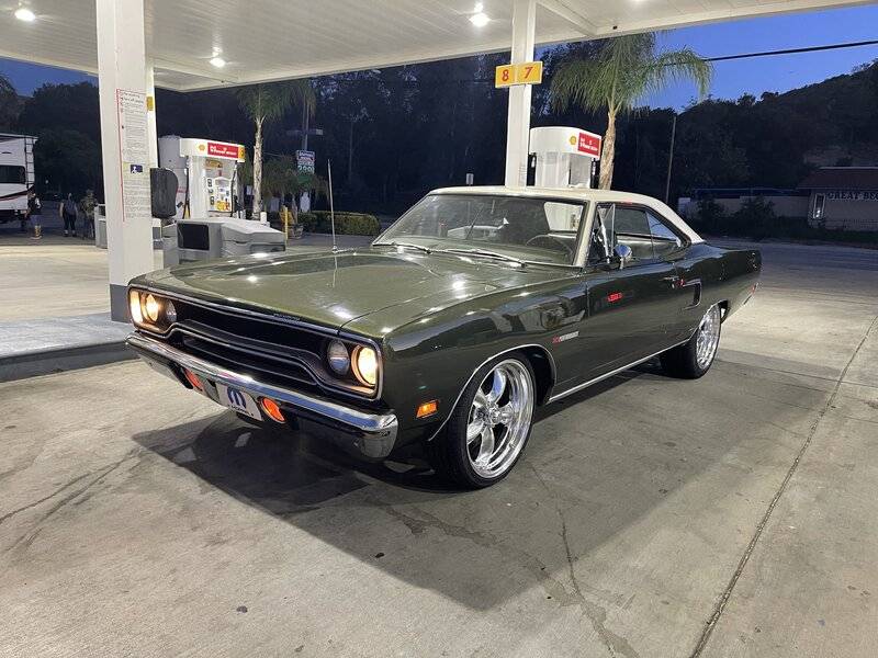

Thanks for the post. Do you happen to know your offset? Is it 5 inches possibly? Where did you purchase your wheels from?
Thanks again
I got them from wheel vintiques, they call them “69 Series Chrysler Police 10x15 5.5 Backspacing
