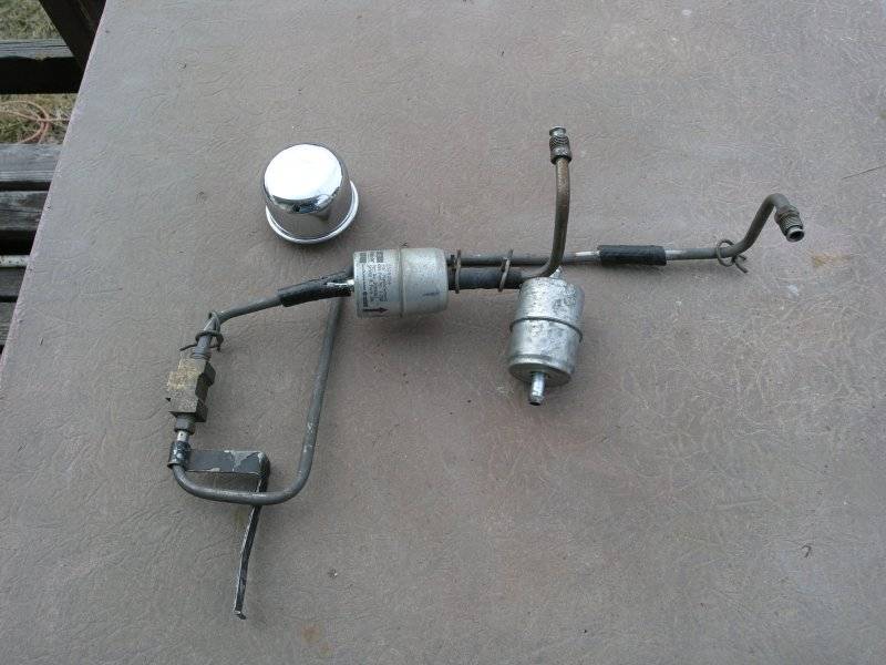

Will Hemi fuel lines fit OEM low deck dual quad (with photo)

Bought a box of "car parts", online auction. They were GenII Hemi. The auctioneer is lazy so the photo showed nothing. The sale ws near me, so I went to look. The auctioneer isn't knowledgeable, not recognizing Hemi valve covers. Especially since the estate had a 1966 Coronet and 1969 Charger R/T, both Hemi four speed cars, both beautiful. Even if you have never seen a GenII, the first time we saw those giant valve covers, our jaws dropped. So I got the box for $60. Sold the covers, but I kept these gas lines hoping they would fit a dual quad I have.
With the filters and rubber lines they are probably flexible enough to fit a B or RB dual quad set up. You don’t have the line from the pump so you would need to find one or fabricate it. Also your rear carb will need a 90 deg inlet fitting. I think the front and rear carb connection lines are reversed in your photo and should be swapped.
You don't have a rear hemi fuel line.
What the photo shows the line in the rear is the front line.
The the line in front is bent the wrong direction for a 426 hemi.
