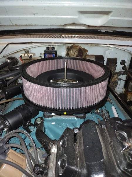

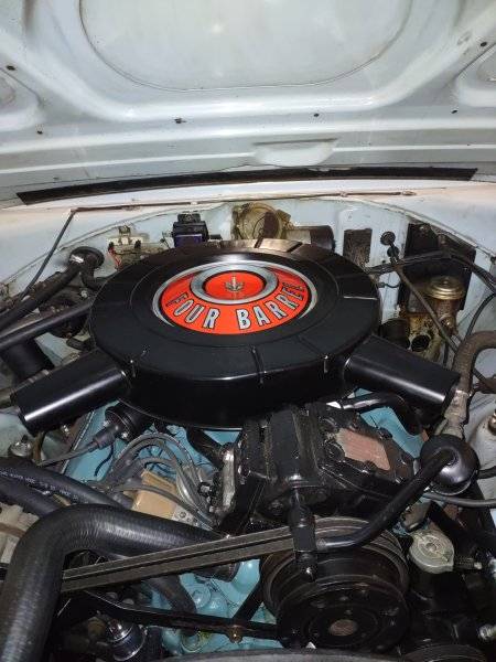

I just changed out the factory closed base plate for an open drop base and a taller filter. My top is the 67 dual snorkel, but it is the same basic cover. I just checked hood clearance and should have enough room to be able to use the stock 68-69 unsilenced base. My project for this weekend.
The factory air filters are 13 inch diameter, while most of the aftermarket ones are 14 inch diameter. There are two Mopar filter heights as well. The one shown is about 3/4 inch taller than the standard 68-69 filter. I believe it was stock on the later model 440 air cleaners.
