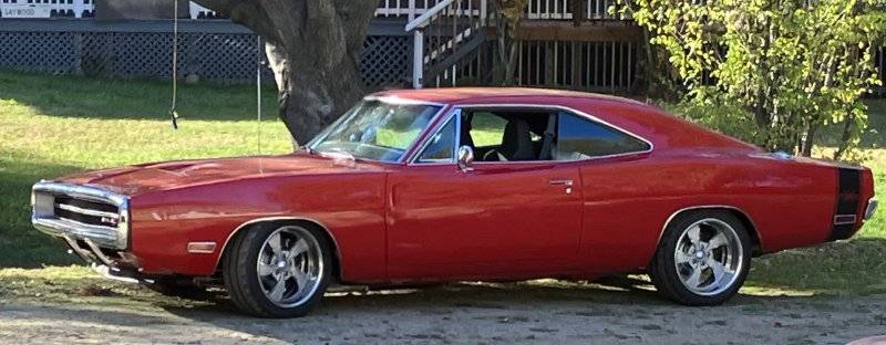

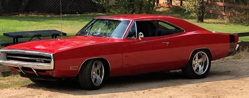

18 x 10" with 4 3/4" back spacing. That puts some offset to the outside. I had 295-45-18s from 2003 to 2023. They were taller than I liked and did rub the outer wheel tub bulge. I modified the wheel tubs for clearance. Later, I went with the 295-35-18s which were rated as being 2 1/2" shorter, 1 1/4" more clearance all around. These would have cleared the stock wheel tubs even though I am 1" lower than stock in the back.
FIRST picture is with the 45 series rear tire.
The next picture is with the 35 series rear tires.
