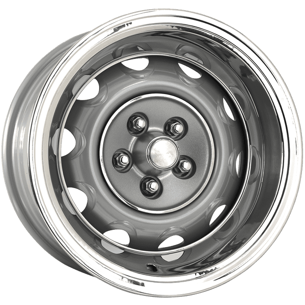

I have bought the magnum road wheels
Without trim rings but I already have ralleys
On my car with trim rings and they are both 14 inch my question is will the ralley trim rings fit on the magnums

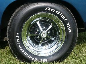

You should not have to use trim rings on magnum 500s.. They have the chrome lip, road wheels are painted lips hence the need for trim rings. SoI assume you have Mopar Rally wheels..
Road Wheel with no trim ring.
Mopar Magnum 500s
If I'm not mistaken 68 road wheels(magnums) where chrome. 69 had trim rings with round valve stem holes.. after that they had trim rings with oval valve stem holes. All you can do is try the magnums on the road wheels.. Depth matching is doubtful.
I have the road wheels and ralleys the ralleys have trim rings I just want to know if they fit the road wheels or not
I do believe the Rally rings are deeper. I have a set of roadwheel rings I can measure for depth if you would like.
I've done some research and found there is a 14x6 and 14x7 road wheel now how will I find out which road wheel size I have to get right trim rings.
Yes the trim rings will work. They used one trim ring for the 14 x 5.5 and the 14 x 6 ralley wheels. Also the road wheels came in 14 x 5.5 , 14 x 6 and 14 x 7 ( these are Ford ) wheels ( stamped on the back edge of the rim ). The 14 inch ralley and 14 inch road wheel used the same size wheel center weld in center ( 12.25 inches ).
