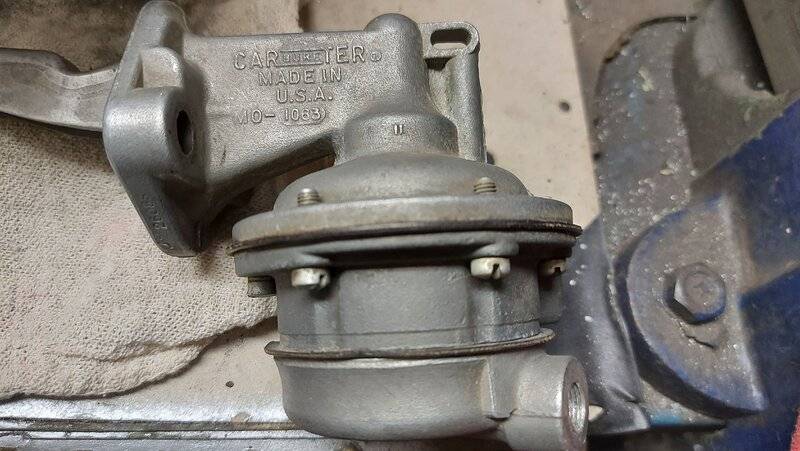

Guys, I have this Carter fuel pump I bought at a swap meet.
Will it work on a 360 engine?

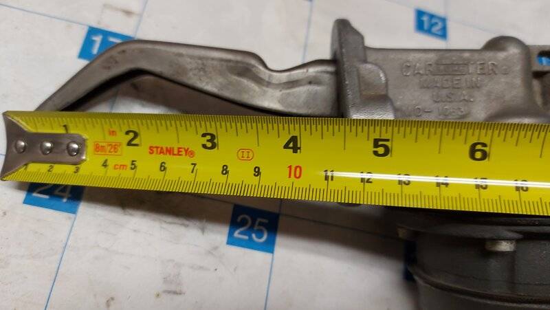

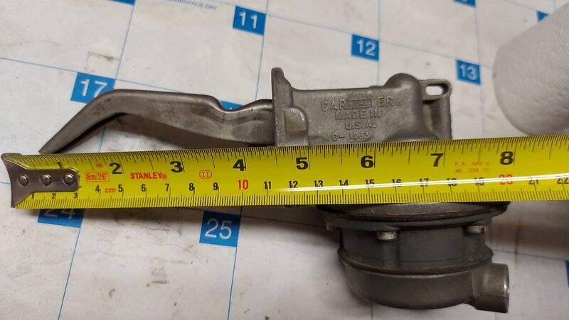

Do you have a full picture, so one can see arm length?
Jerry - yes I do.
It's pretty much 4 1/2" from the end to the mounting base.

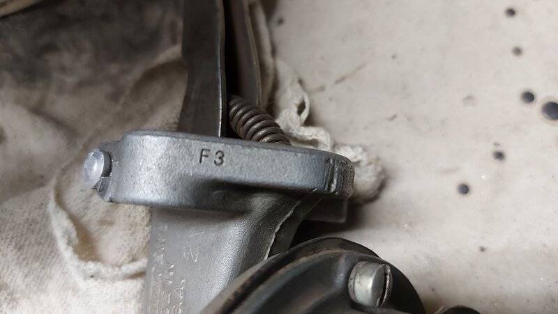

I had a guy on Moparts say this about the pump.
"Looks period original and the F3 date code would be Jun 63. The carter book has it for a Dodge Desoto and truck starting late 1957. Listed as a 5 to 7 psi pump. The mopar service manual have the carter pump number so you could look up for more specifics."
I, am saying yes. It's definitely not a big block fuel pump.
