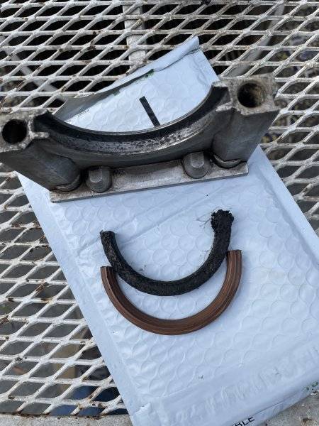

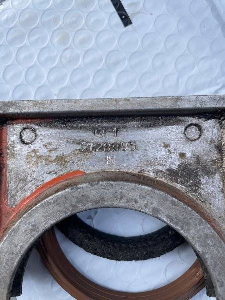

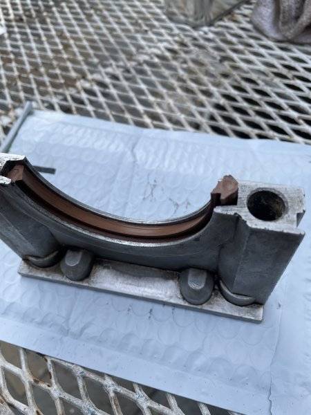

Got the rear main seal end cap out. Had rope seal in there. The valley where the seal sits seems a bit large. Will my new seal work? Is this an aftermarket end cap? Finally what is the best way to remove the upper rope seal still up inside the block?
