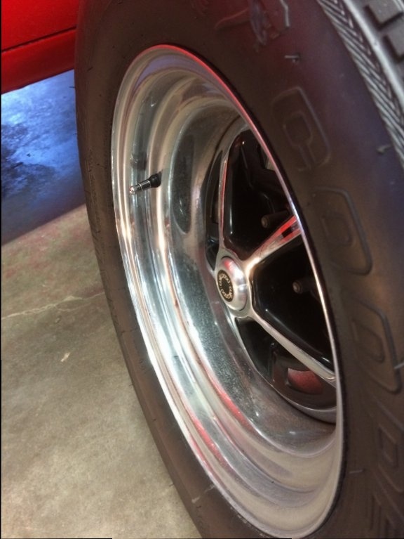

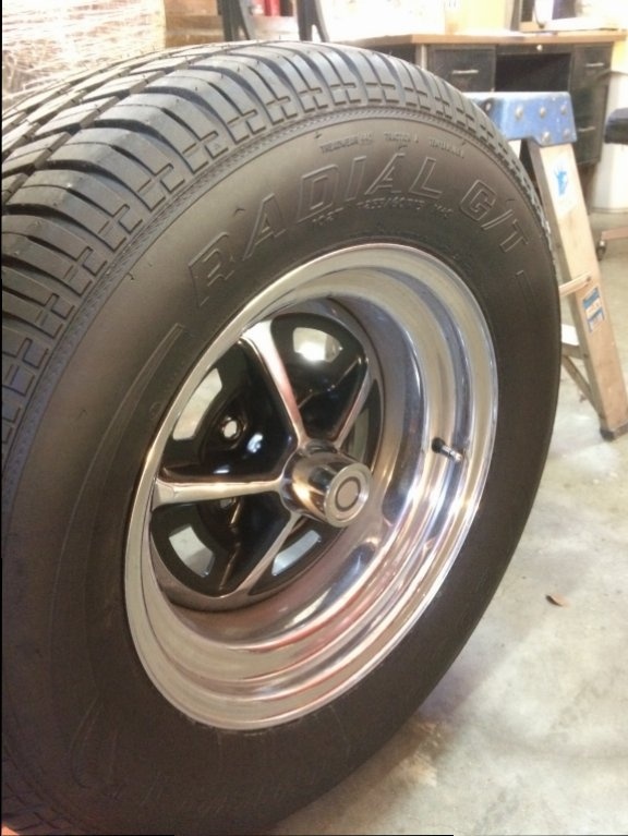

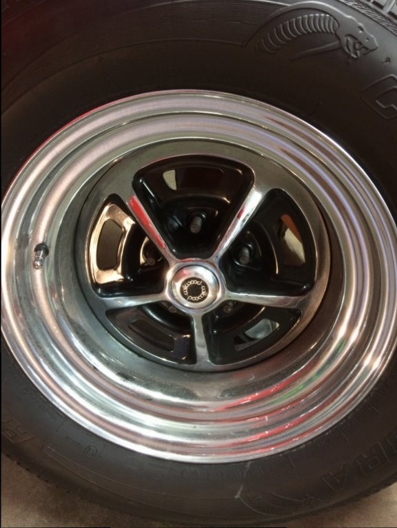

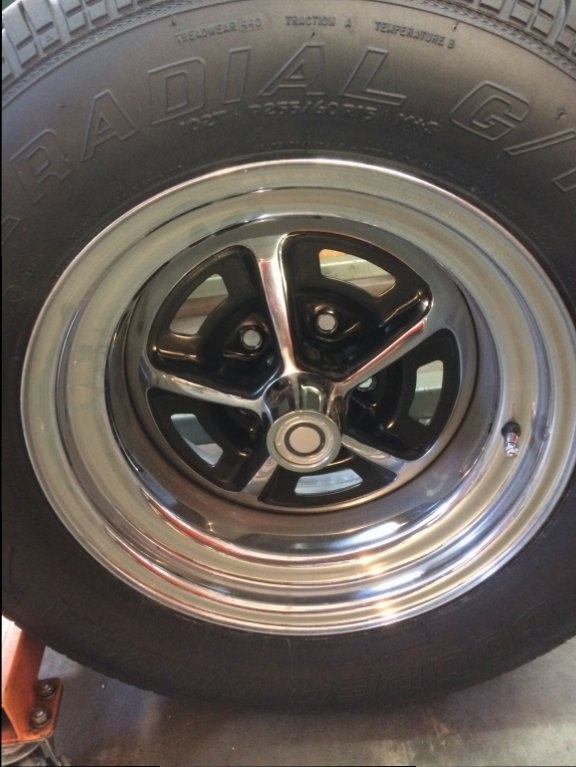

When we went to install my new Willwood's I noticed the new hub come through just past the surface of Wheel Vintique Magnmum 500's which makes using the Magnum wheel centers impossible.
So now I will have to find center stickers. I am 50/50 on this. Part of me actually prefers a flatter center instead of that trucky old school look. And part of me like the old school. Will post pics when done.

Wheel spacer would be an option, doesn't look like you need much room
True. But I'm actually thinking the lower center cap makes the wheels look a little more special in the sense that the tower-ish center cap doesn't detract from appreciating the wheel. If that makes sense.

Same on my steelies, I painted the wilwood caps black to match the wheel and hide them.
Any update on this? Had front disc conversion completed on my RR, and am dealing with the exact same issue. Wouldn't mind losing the long caps as long as all 4 wheels have the same look. Now, I've got the Wilwood caps on front, and large original caps in the rear.
