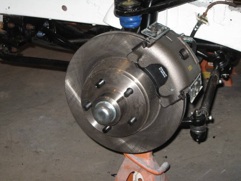

Stock mid 70's "A" body manual disks and knuckles. I have less than $500 in the entire setup.
