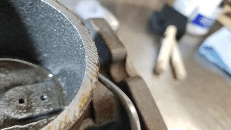

I can't answer the Wilwood question, but I can tell you my master cylinder leaked twice and screwed up my paint on my inner fender :BangHead:
I finally figured out that the machining had produced fairly large ridges on the top where the lid had to seal. The brake fluid could seep through these ridges. I took the master cylinder off the car, laid some sandpaper on a flat surface, and sanded down the ridges. It hasn't leaked since!

Yup....remove the fine ridges. This is Hawk's MC.....and if you go to the link he posted it'll show more of what he did to it.....

Yup, same thing happened to me. Brand new MC, took her for a drive and when I got back the brake fluid was almost gone! I cleaned the inner fender the best I could so I hope it doesn't start to dissolve the paint. I'm going to check the ridge and see what it looks like. Thanks!
I looked at the MC and could not find any ridges. I don't want to take any chances ruining my paint so I went ahead and ordered the wilwood MC. I should have ordered it to begin with but I took the cheap way out. I went to a car show today and was surprised at how many cars had the wilwood MC, so I guess its a good product.

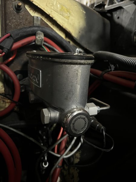

I have the Wilwood master cylinder and I have never noticed it leaking. I have the raw aluminum version and I have noticed some corrosion below the lid, but no discernable brake fluid.
I ended up buying the wilwood MC for mopars. It fixed my brake problems! Well worth it!
