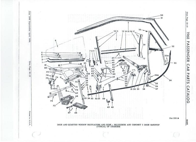

Here is an exploded view to help you out.
