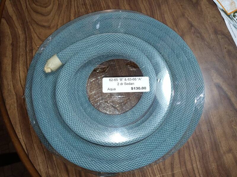

I bought this for my cars, from 2 Venders, same product.
In the past 30 days I spoke with Dante and he could have ordered me the Aqua but it had a 6? week lead time...I opted for just the black as it was in stock...
Nothing else is correct on my car and it never had an Aqua interior originally anyway...

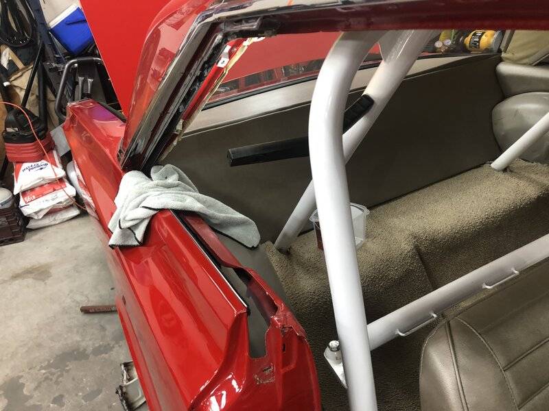

Last I heard from a vendor (couple years ago) there’s only one outfit producing them per a vendor that is or used to be on the forum, and in my case they were crappola. Way too large though it suggested to install and keep the doors shut for a week or so. That was a total fail plus I effed up the door latch on the driver’s door having to hunt another one down. Had to slam the doors; never a good idea. And as posted, they were clothy unlike the originals. It was suggested to do some minor fabbing to accommodate a fit that I didn’t want to do as these run under the sill plates. Ended up returning and re-installed the old lace calling it a day (or two weeks). Could be there are better ones available now.

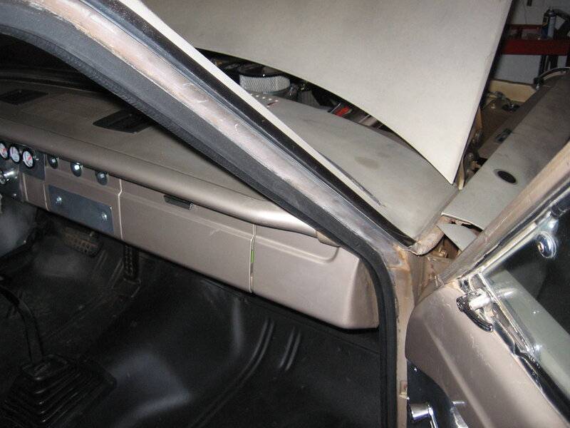

Bending the flange inward helps. Also do a careful examination. Many times the edge of the door or dash gap to the door is to tight. It may cause the material to be pinched in between the two. I actually cut, thinned, and rewelded a section at the top of the passenger door. I could see where the old strip was pinched to tight and was damaged. The tight spot really worried me as the entire inside section of my door has been removed for weight. As you can see these tricks were successful. Door closes well.
Doug

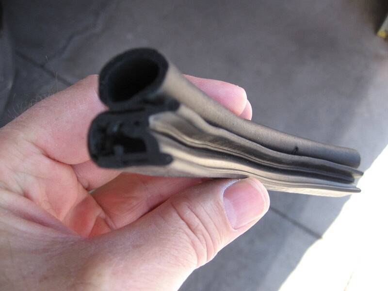

And for you budget friendly guys like me that don't need OE original/colors.
I found that Dodge trucks of the 80's have all black rubber. Long enough to do a 2 door sedan.
Did my 64 Dart sedan and 4 door 63 Belvedere with it from Rock Auto. $13 a door (Price was 3 years ago.)I bought it for my 88 D350 Ram too.

Ron H, worked for me. Doors close fine and seal tight. Even has a sealer/glue inside where it attaches to the pinch weld.
