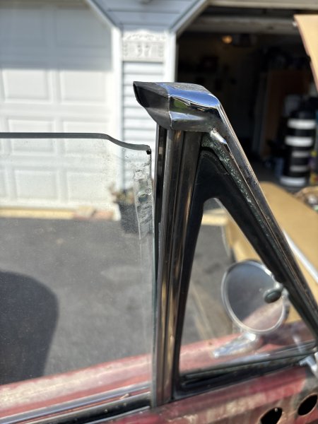

Two things. Wher are the adjustments to correct the window being too high towards the back and should the hole be attached to anything inside the track? As I slide the window down the widow goes all over the place.
No need to think about adjustments yet, that vent wing and glass have to be pulled to replace the slider that goes on the glass
Adjustment is on the door itself in the door jamb area (near lock, etc). You need window guides for the glass
