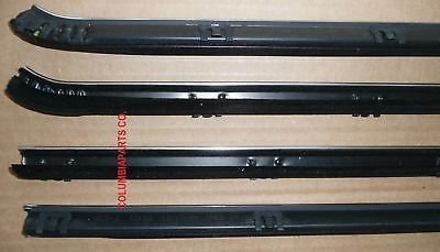

$_1.JPGFound a good picture online for you.
Look at these clips, they look like a capital "M". The middle part of the "M" slips into the slots in the inner and out door frame to secure them
