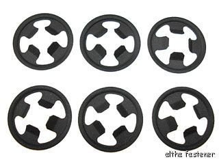

Joe, can you post up some pics of what your talking about? I think I need new for mine, but not sure what they look like or where they go.
Here ya go these are the clips they are talking about. BTW I installed my regulator assembly while the quarters where off, made it the easiest thing I've done so far.
  • Chrysler-Dodge-Plymouth-window-regulator-arm-clips-for-sale_130460645734.jpg

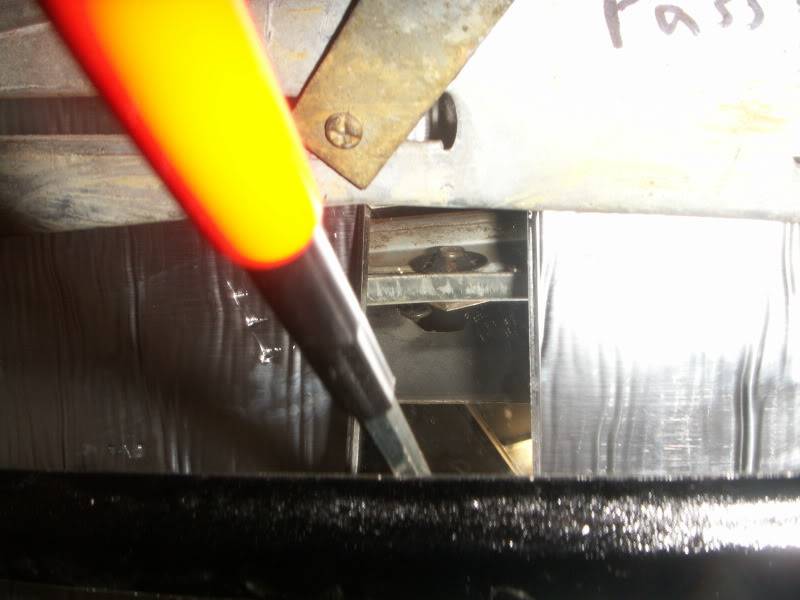

^ Yes those are the clips. I took a picture showing one of them installed on the window but I'm sure you know now where they go by seeing it.
Thanks guys. I now know what to look for.
