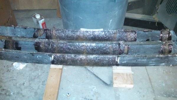

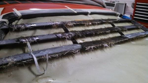

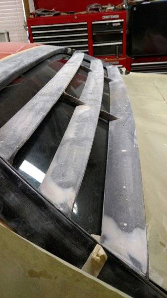

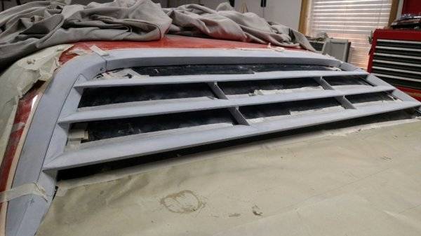

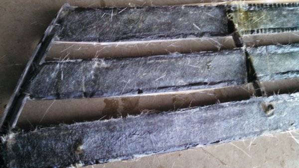

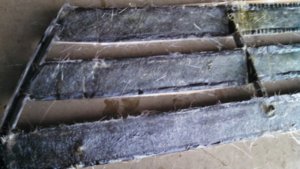

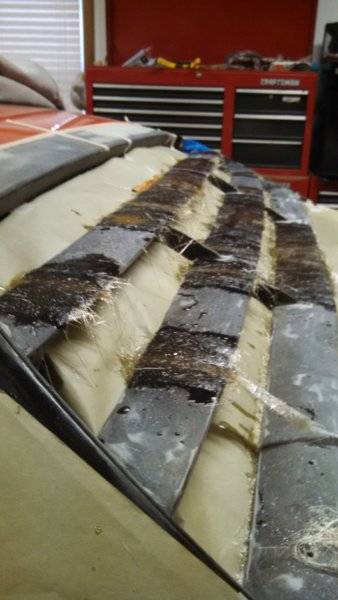

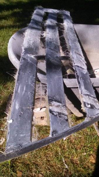

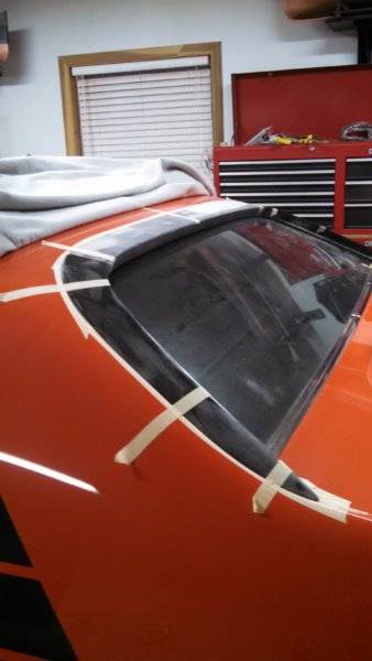

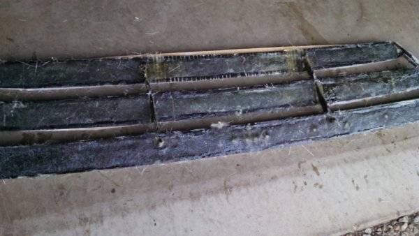

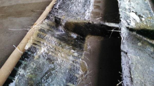

Thought I'd post a few pics from the rebuilt of a set of original louvers. The center section was warped with sagging slats and the right side piece was cracked. I did a 2 sided mold of the right piece and completely remade the piece. Don't have pics of that. The center section was cut and spliced to get the correct fit and the the bottom was completely ground out and layered up with glass to get the curve. Hope you enjoy.

You have no idea lol. It took less time to completely remake the right piece which looks OEM on both sides, than it did to reconstruct that center section.
