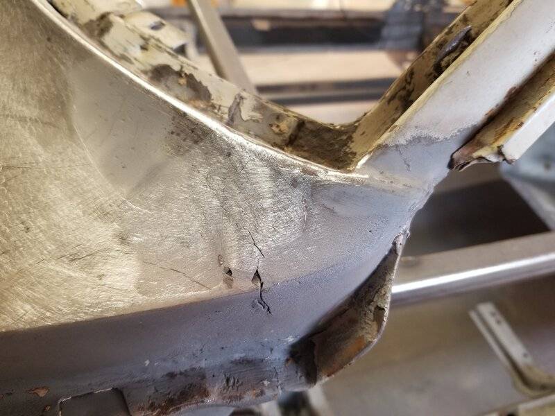

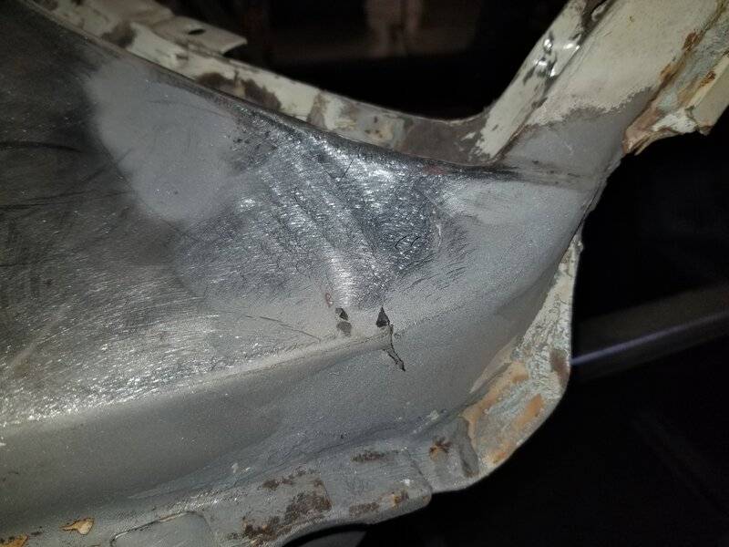

Hi, I have cracked lead by the windshield pillar lower corners and was wondering what your opinion is to the best repair process is. Thanks in advance
Our body man cleaned it all out and welded in a patch piece, shouldn’t ever flex and crack again, did the same on the sail panel.
Melt it out and fill with All Metal.
