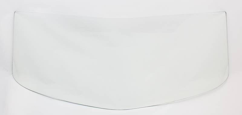

I don't know exactly what you have but a replacement windshield doesn't cost that much from AMD (same price for clear or tinted) and others. Something to think about.
http://www.autometaldirect.com/prod...0AnedDmebsiKEdNquKagszXlJm_Jo504aAkP2EALw_wcB
