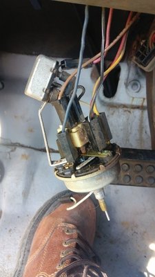

I changed the switch.... No more problem. Wipers run, case stays cold and they shut off by there self didn't use to.
Bad switch I have 2 of these cars and I took the switch out the other till I find one to buy new.
Thank all of you again... Very helpful
