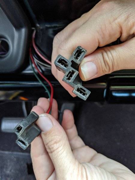

71s uses two plugs like these

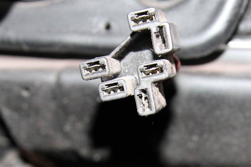

While 72/74 uses this one piece plug

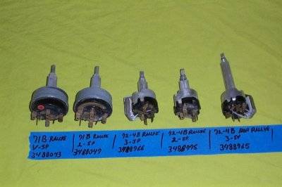

Switches side by side
The shaft lenght just makes diff between standard and rallye clusters. Long shaft is for standards cluster on B body. Every switch has its standard cluster version. On the pic for example we can see the 72/74 3 speeds for Rallye and for Standard clusters
And pretty sure same diff applies for diff bodies, with diff shaft lenghts and nut attaching for each cluster body kind but everyone being pretty much the same switch, but if the attaching nut, hole provision on dash/cluster, shaft lenghts, room behing the dash/cluster allows that, you could use an 73 A body switch into a B body cluster. Electrically they must be the same.
sure another diff would be if manual or electric pump washer. All these switches on pic are a built in washer pump push in function. A bodies could be foot pump or electric so this makes a diff into the switch, but motor itself will work the same with either switch
