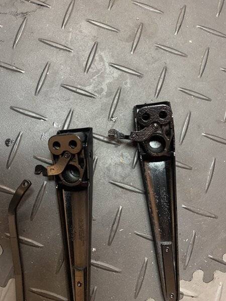

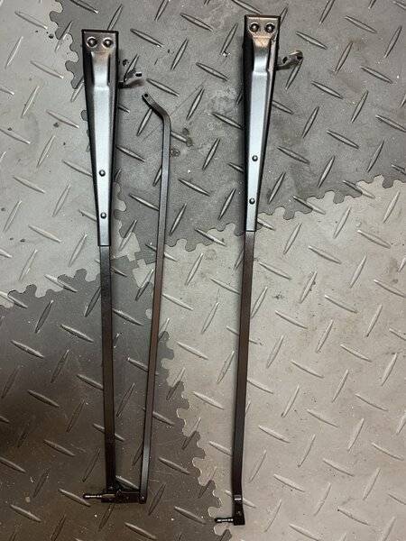

These were included with my project car, and not mounted, so I cleaned them up and painted them (I like the black better than plain metal). Other than the wiper blades and their own frames, am I missing anything?
Thanks!

Do you have the clip that holds the pivot arm on for the drivers side wiper?

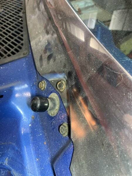

While not missing from your application, I've had a couple of B's where I added the later B windshield washers that were right on the arm instead of two squirters on the hood. Always seemed to do a better job cleaning the glass.
Am I missing something, or do these rubber ends come off to expose a knurled end?
