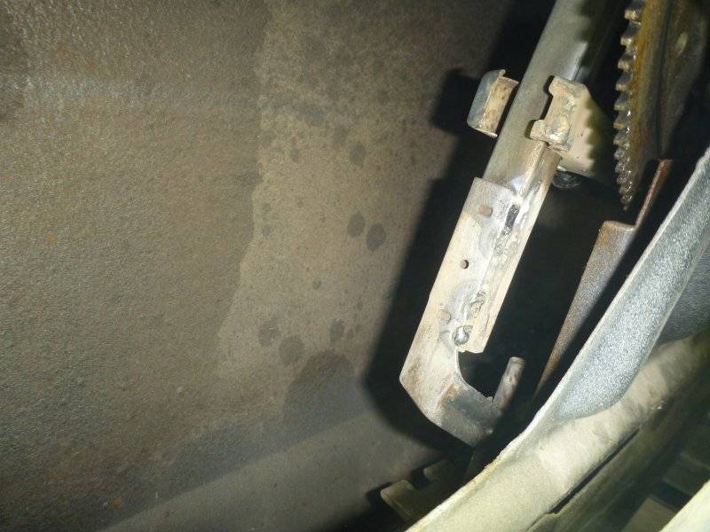

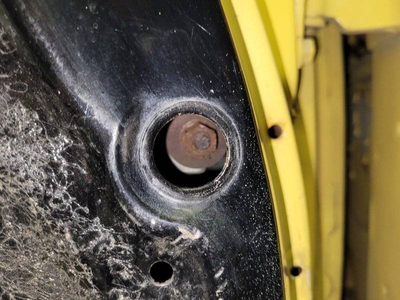

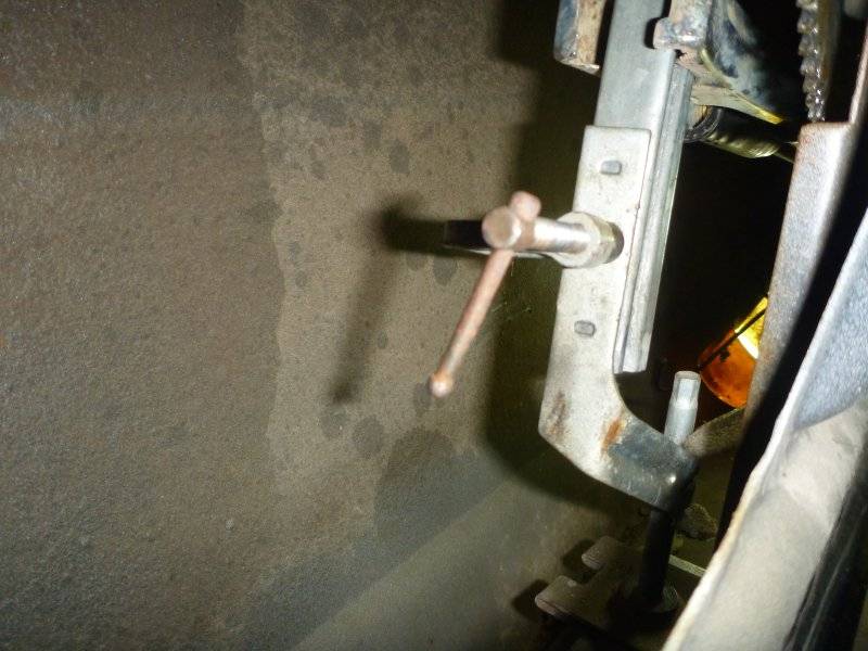

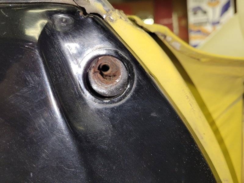

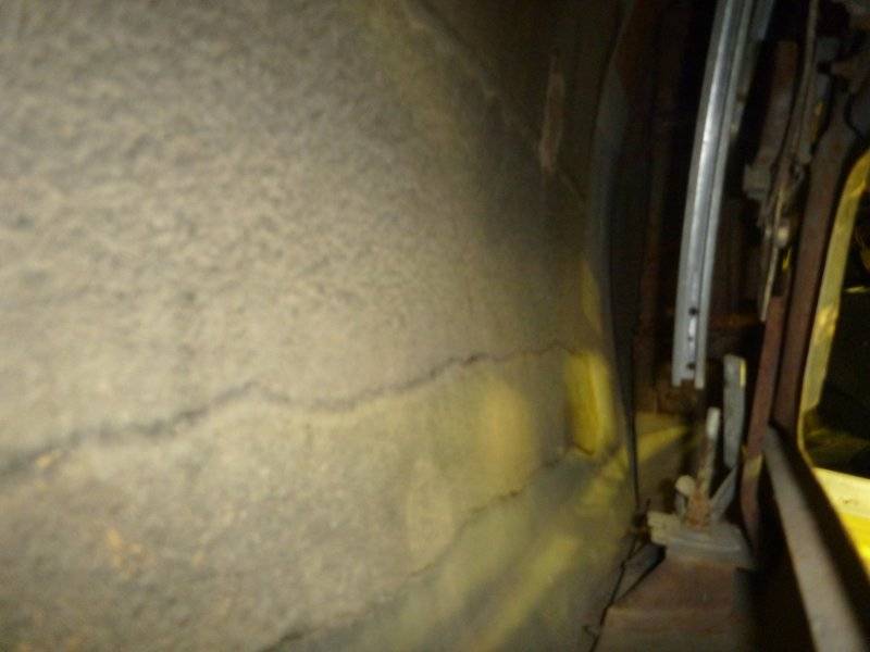

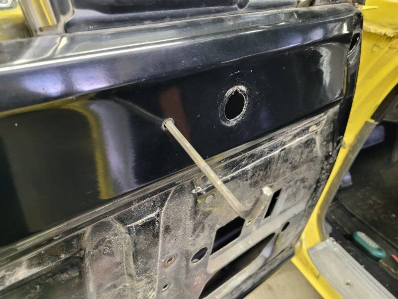

I'd guess that the track "foot" is broken off at the bottom... otherwise there is only the allen key "clamp" at the top of the track (access via the little black plug) and the forward vent frame arms bolt and nut behind the two 1" plastic plugs.
I'd guess that the track "foot" is broken off at the bottom... otherwise there is only the allen key "clamp" at the top of the track (access via the little black plug) and the forward vent frame arms bolt and nut behind the two 1" plastic plugs.View attachment 1368911View attachment 1368912View attachment 1368913View attachment 1368914
Thank you I will go to the shop to check that out on Monday.
