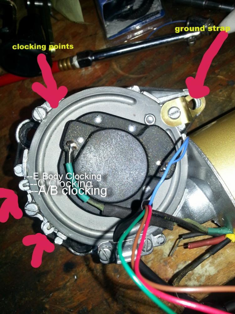

I have a 71-2 wiper motor in my 69 and was able to fix the park feature by making sure the body of the motor was properly clocked on the housing. Its also important to make sure the copper ground strap is on the top right bolt on the unit and is making a good connection.
Pics,
Notice mine originally was not clocked correctly (little tabs in notch) plus the rod that hits the switch inside was not making contact and needed alignment, those combined fixed it.
Pics,

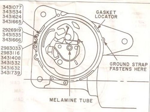

You're clocked for an E body. Not sure because the OP didn't state if he had a three speed motor, but does mention a two speed switch. Yours is a three speed/variable speed and they are totally different animals. BUT, yours is currently clocked for an E body if that's where you have it clocked.

Yep it's on my 69 RR now so I had to re clock it to make it work, among other things to fix :) yes I think he said his was a two speed just trying to give him some ideas like the ground strap.
