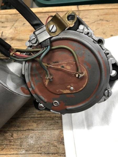

Can anyone help me with the red corrosion sealant on the wire terminals for three speed wiper motors I need to freshen it up
Thank you
Found some on line. Smallest is quarts over $50 a qtr. wondering if there is something similar in smaller amount?

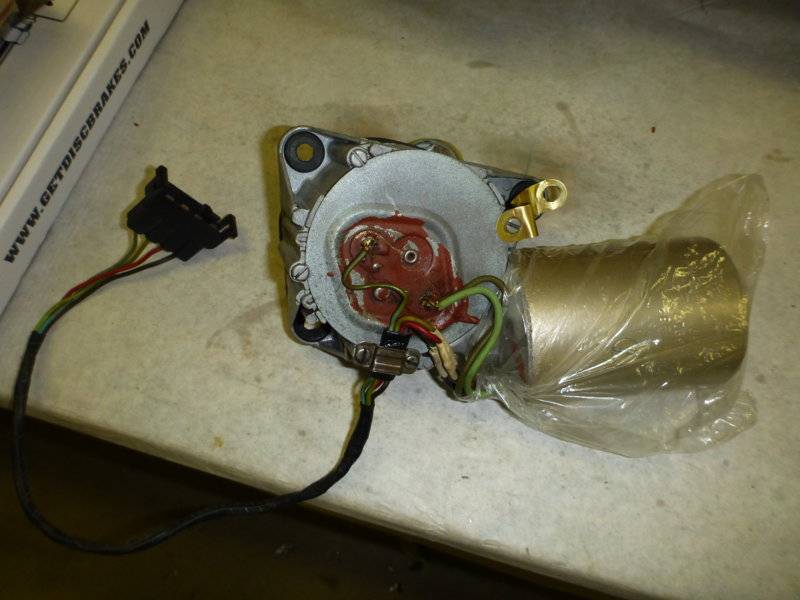

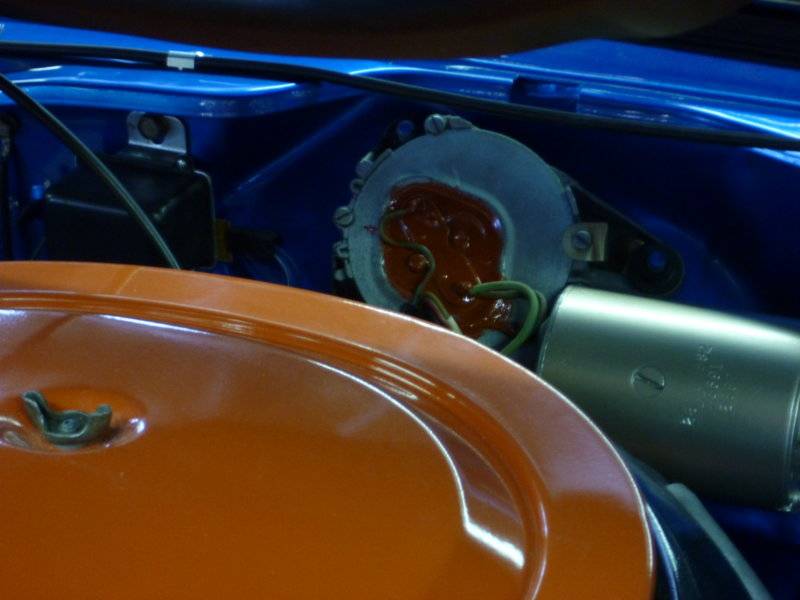

Looks good to me. Thick, doesn't run and just slightly brighter (which it should be) than the 50 year old OE coating. Mine done and enough left to do a thousand more wiper motors!
