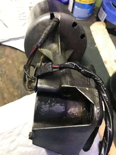

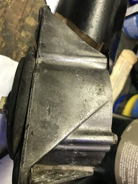

Hi! I am restoring the wiper motor assembly on my '68 Charger. It appears to have some sort of thin coating on it, but may just be dirty. How should I correctly finish the assembly? Bare metal with some sort of clear coat, or is there a paint that should be applied?
Thanks in advance for your help!!!

2 speed the barrel is painted black, 3 speed it is plated. I send mine to a guy who makes them look like museum quality and has all the correct plating and factory appearance.

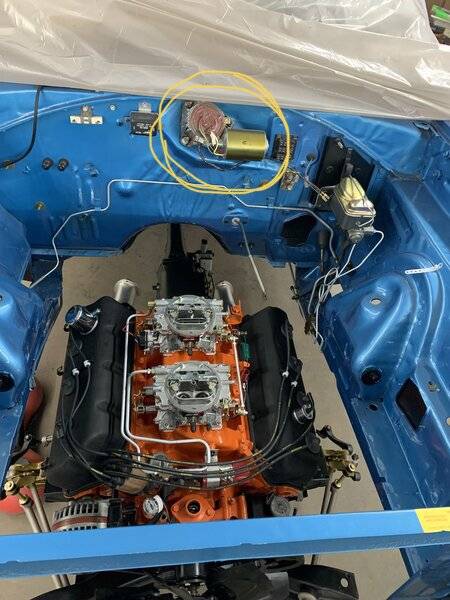

I did this one inside and out.

Wow, SWEET RIDE!! Great job, Beekeeper!! Did you clear-coat the bear metal surfaces to keep them looking so fresh? If so, what did you use?
I used a duplicolor yellow that’s translucent on the motor barrel the rest is bare.
