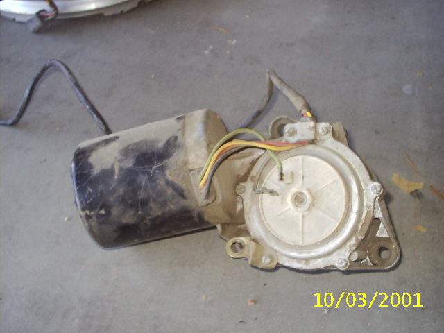

I have a wiper motor and would like to know how can you tell if it is a 2 or 3 speed wiper ? I can probally get a number off of it but I thought if you looked at the wires you could tell ?

That is the problem, I looked at it and couldn't find any numbers. I know it is NOS . I have had so many mopars over the years, but I am thinking it could be 67-68 or 69 probally a Fury, but like I said I am not sure. I will try to post some pictures to see if that helps. I am guessing that it could fit alot of others. Also where would the numbers be on it, the only number i found is on the motor itself , which is Leese Neville 364.

Post pics and hopefully someone would be able to help.

3 speed wiper motor
I know the area that is called the "FLAT FACE" on the wiper motor's for a B-body car is a 3 speed wiper motor....... not sure about the C-body one's.
I agree, definitely a 3 speed....2 speed, the motor sticks out into the engine bay, unlike the 3 speed which rides along the firewall.
Its definantly a three speed, but the motor itself look bizzare, almost like its for a truck, doesnt look like the one in my 68 Fury.....
motor
I am pretty sure I got it off a 69 fury, I had one at one time and collected alot of parts for it.:confused5:
