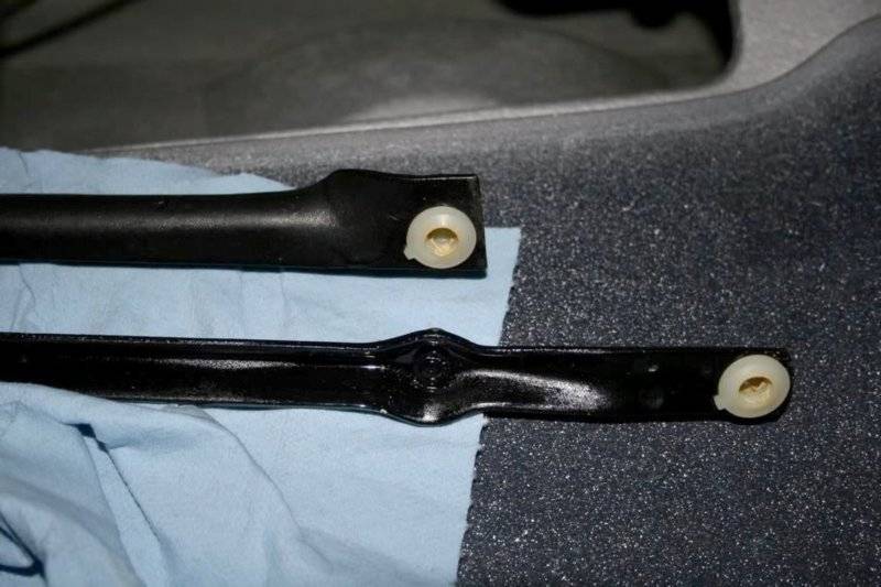

71-74 with hood up, yes. Quite common failure on 3 speed is these little buggers, they get brittle and fall apart. You can find them at NAPA or order them here.
http://www.megapartsusa.com/proddetail.asp?prod=MP-WLB101
BTW, the platform wide production change, for both 2-speed and 3-speed, from brass pivot bushings, with retainers, to the plastic snap-in bushings took place “Approximately June 1, 1972”, late ’72 production.

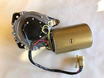

Two speeds

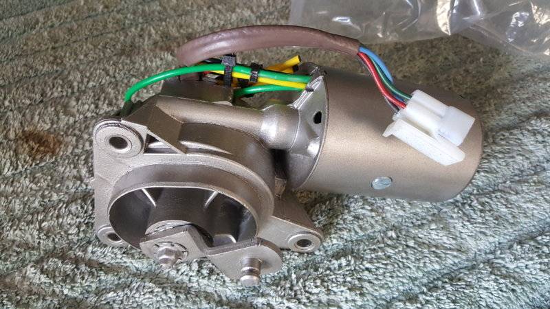

Three speeds

off, low and high positions on 2 speeds
off, low, mid and high on 3 speeds

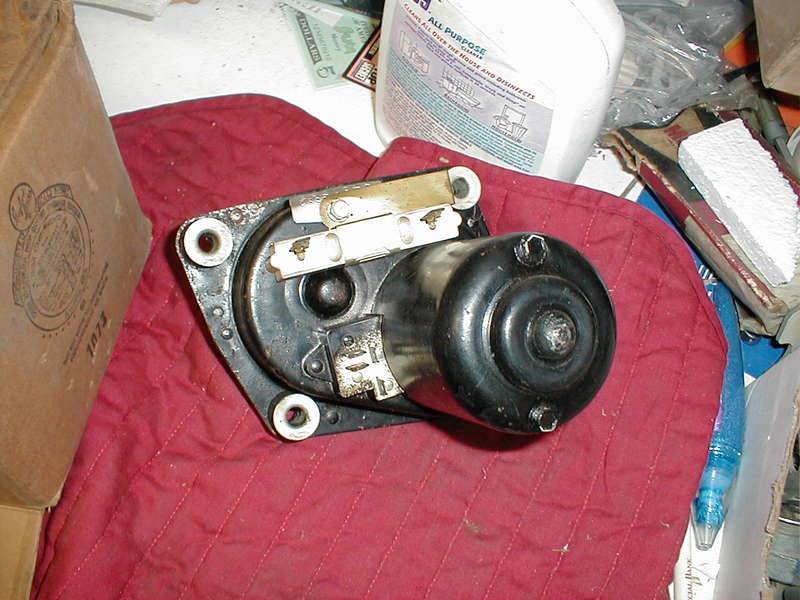

OK well then I have the three speed as evidenced in this picture

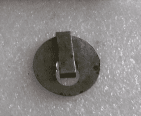

I had the crank arm fall off the motor shaft on my 2 speed. There is a clip that rusted. I was able to obtain the clip from ebay that looks like this:
Was able to get at it through the cowl vent.

How many of those bushings are needed? Now that I have the car running items like wipers need to be addressed. I ensured all the exterior lighting was working today, only had to replace one bulb.
I believe there is one on each end. so 4 total but it's been a while. even if it is only 2 they are inexpensive enough to keep a couple in a drawer for when they break again. BTW, Napa has them.
I believe there is one on each end. so 4 total but it's been a while. even if it is only 2 they are inexpensive enough to keep a couple in a drawer for when they break again. BTW, Napa has them.View attachment 733771
Thanks, there are 4 packs, 6 packs and like 40 packs of them all over eBay. I didn't figure it needed 40 but 6 wasn't unreasonable either. Ill look for them at NAPA.

I can't see if the motor is with or without tower on it. 73 should be with towered cap
