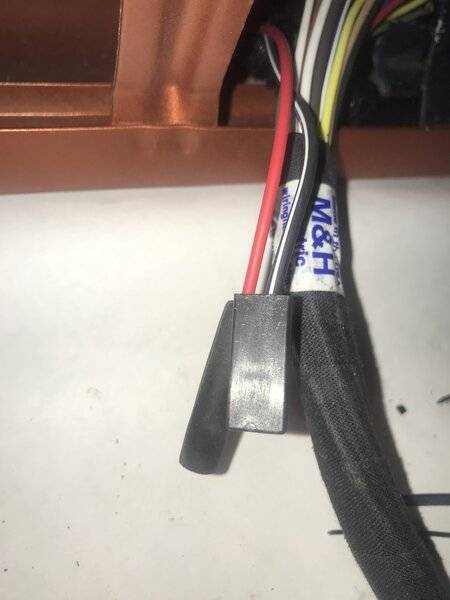

Which Way This Plug Connects?
Does It Matter..
Yellow With Black Tracers
Black With White Tracer
The Last One Is I Think For The Radio.
Just Wondering If I Can Take One Of Those Wires And Use It For Keyed On Ignition or Power Source For My Custom Auto Sound Radio. Thank You
Top------ if not indexed it should go either way
Second-----Should be for the lights on warning buzzer.
Third--------Red cigarette lighter and black to blower switch
Bottom ------is radio. Red with tracer keyed 12 volt and orange is radio lighting

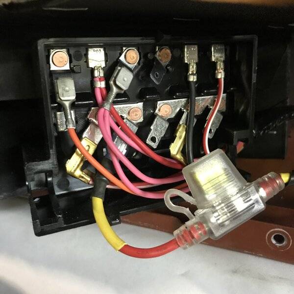

By Any Chance You Wouldnt Happen To Know Which One Is The Red Side Or Black Side Of The Fuse Block..
Im Not Sure Where Abouts To Hook Up The Yellow ‘Bat’ Wire For My AftermarkeT Radio
The buss bar bottom left red with a white tracer. Make sure you fuse that circuit as it is 12 volt hot and only protected by the main fuseable link.
Thank You!
I Will Tap Into The Free Spade Terminal On The Right Of The Buss Bar and Add An In- Line Fuse..
Appreciate The Help!

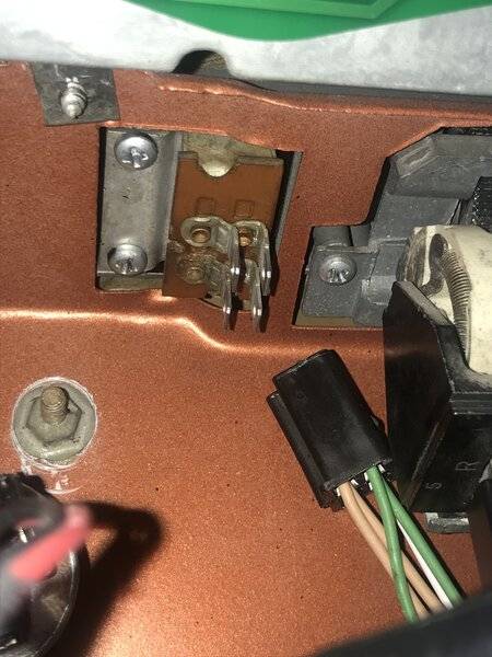

Any Idea Where The 4 Brown Wires Go?
I Know 2 Are For The Washer Fluid Switch But Not Sure The Other 2
Thank You
Wiper switch. As I remember both are used with the three speed switch and motor and only one with the two speed motor. The switch has a tab on the male spade which mates to the female spade's plastic insulator which has a receiving groove cut in it.

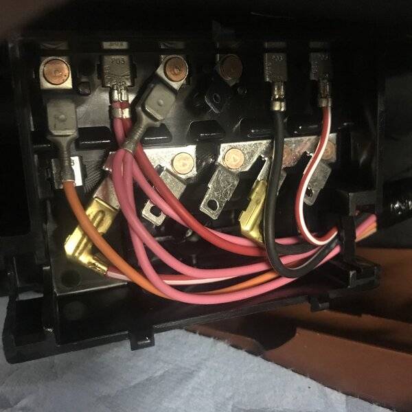

Last Few Wires Im Not Sure What Buss Bar To Tap Into. Thanks Guys

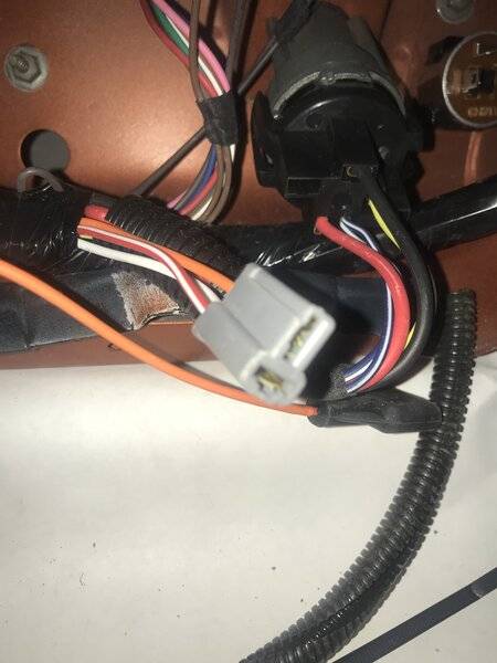

just Wondering Where Abouts I Should Hook Up Power For The Blue Tach Wire and Green Defrost Wire?
The Guy Who Made The Defrost Harness Said Piggy Back Off The Green Wire at The Fuse Block But i Dont See One. Thank You
Ps.. The Fuse Holder Is For My Aftermarket Stereo. Hope I Tapped Into The Right Spot
Your third picture shows the heater wire. Black with a white tracer.
Tachometer top row third from the right. You photo shows an unused spate terminal. On my charger the lights on warning buzzer shares the same terminal.

As For The Black With The White Tracer How Should I Go About Tapping Into That One For The Defrost Power..
I Dont See a Spade On The Back Of That Wire On The Fuse Box?
Thank You!
Awesome!! Thank You!
Thank You!
What defrost power are you referring to? Front window or rear window. The black with the white tracer plugs into the blower switch harness.
