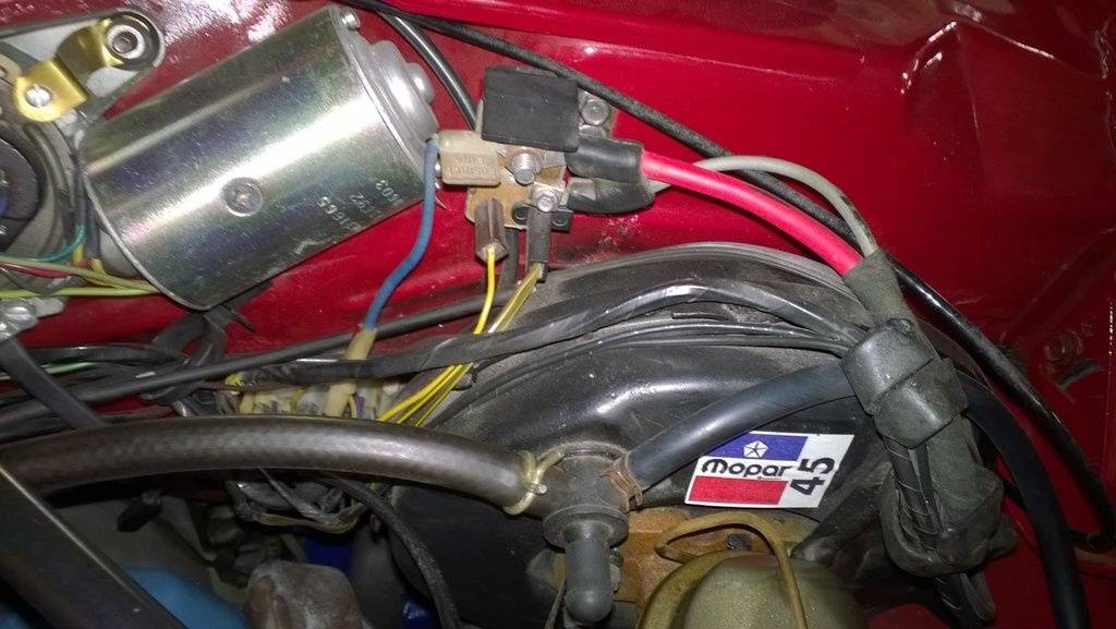

Need some ones help out in Land of Mopar.
1973 Dodge Charger SE ,could somebody send me some pic of where the wiring harness is routed from the bulkhead connector to the left headlight.
As this car was converted to RHD is is now back to LHD ,the wiring loom had been shortened and added too. (TFU)
What appreciate someones help.

I think the brake valve has a wire loom bolted to it.
From there it goes in a plastic channel that clips to the inner fender, then behind the battery, and through a hole in the core support.

Thanks for info,it now gives me a starting point.

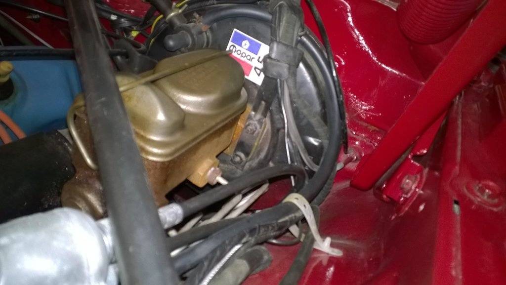

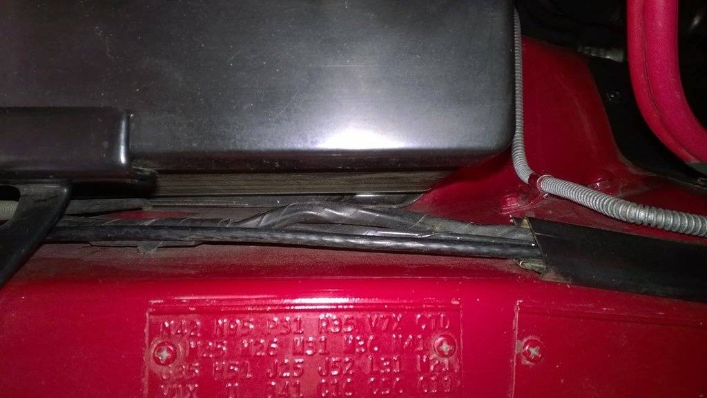

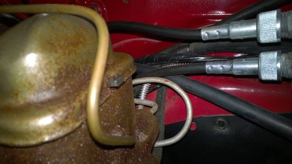

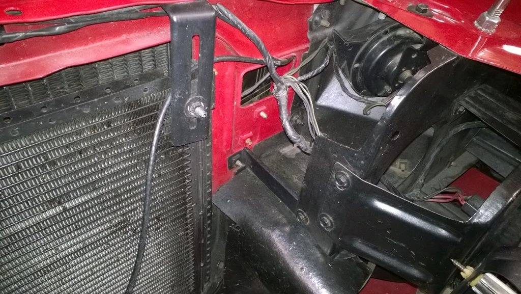

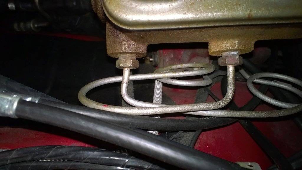

OK, here are the pics I took. Mine runs right along the fender well and up over the master cylinder/booster.
Cruise is in the way for part of it but I hope these will help you.

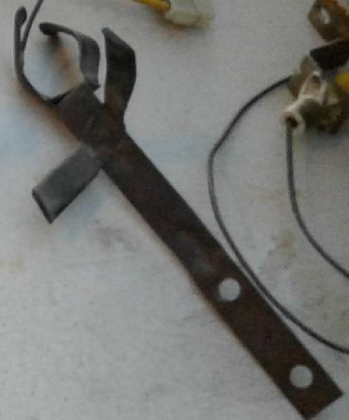

Let me know of you need the brake master cylinder wire loom bracket, I have a few of them.
Hi Guys,
You have helped me more than you know? I now where the loom goes,and in the first pic I know were the splash shields fit.
If I need the M/cyclinder loom bracket you'll be the first to know.
