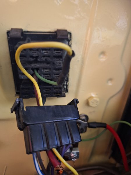

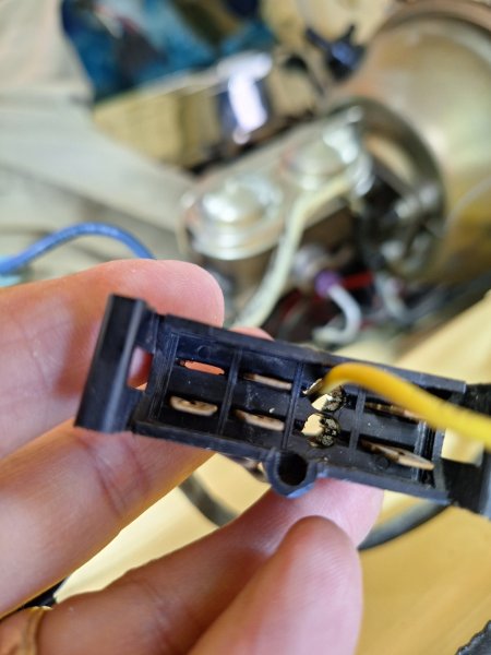

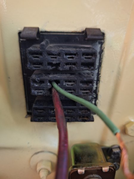

I'am in the process of replacing my wiring harness.(first time ever doing).2 I pulled the 3 plugs from the firewall and noticed the middle plug had 2 wires coming from inside the car, hard wired to the existing wiring harness. One is a thick black one and the other a yellow wire. (See pics) It looks at some time the plug connection failed and someone spliced directly to the harness. Also the connector on the firewall doesn't look too good. Any suggestions on what I need to do. Also who has the best and easiest harness to install. The car is a 1967 Plymouth Satellite 383-4V, automatic with electronic ignition. Electrical is not my thing so any help is greatly appreciated.
I'am in the process of replacing my wiring harness.(first time ever doing). I pulled the 3 plugs from the firewall and noticed the middle plug had 2 wires coming from inside the car, hard wired to the existing wiring harness. One is a thick black one and the other a yellow wire. (See pics) It looks at some time the plug connection failed and someone spliced directly to the harness. Also the connector on the firewall doesn't look too good. Any suggestions on what I need to do. Also who has the best and easiest harness to install. The car is a 1967 Plymouth Satellite 383-4V, automatic with electronic ignition. Electrical is not my thing so any help is greatly appreciated.
That’s the bypass the firewall plug trick, my 67 Plymouth had it also. I got a new wiring harness from classic.
Did it many times back in the day. Usually the power feed from the starter relay and the alternator output. Easy fix for burnt connectors in bulkhead connector.
Bulkhead charge circuit by-pass, one older approach is running a drill trough the melted cavities and running a direct splice through.

From what I can see in the pictures the wires actually look pretty good along with the male engine side connectors.
I'd consider getting a bulkhead connector (Dante's sells them) along with a handful of new female sockets for the bulkhead.
Clean the good female ends and re-use what you can.
Consider a solid connection or perhaps barrel connectors on the wires that were bypassed earlier.

They can get pretty crispy up by the temperature sensor.

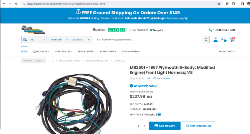

Classic has the harnesses already modified but I understand that Evans will make it any way you like as well.
Note this has plugs for a Dual Ballast Resistor setup.
