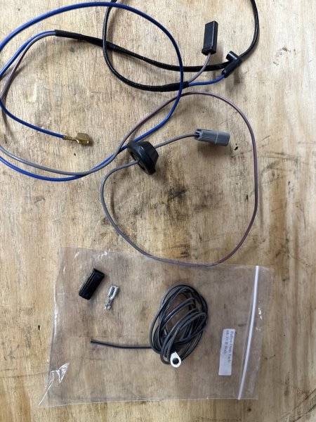

Car originally came with only the clock. The OER ttt unit is installed. I have the harness from Bill but really unsure now of proper connection points? Are all or only some of the harness connections used?
Is there a Mopar Wiring for Dummies manual? Appreciate any direction guys!

It would help to know which model and year Simca you are working on. The tach feed from the coil is a separate wire not made with any harnesses.
To be clear, you’re saying for my make model the Evans harness doesn’t have a needed wire to the coil, and the Mega Parts harness is what I need instead? Correct?
The original Chargers all had the tach wiring in the harness. They all had tachs. After that I guess they watered them down to optional tach? Interesting
It sounds plausible with the 70, they came out with the XH cars.

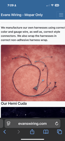

I posted the wrong picture sample to the original post. See the actual one I got from Evans.
(FYI I did get the info on connection points so good there now)
The correct pictured Evans harness includes a separate gray w/black stripe coil wire to be cut to length and connected with a female spade connector that plugs into the harness’s pigtail fed through the firewall on the engine bay side.
