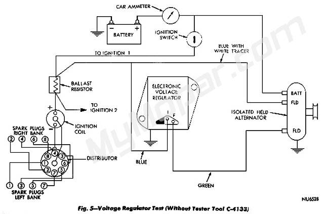

this is the best way to understand what mods do you need

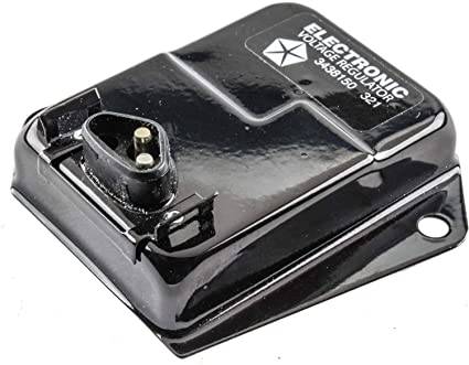

with this reg

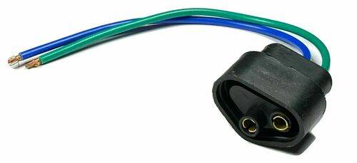

This pigtail to conect the regulator

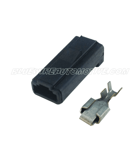

a female packard terminal and plug
And a section of 4-5 feet long of 16 gauge blue wire along with couple of splices will make the job

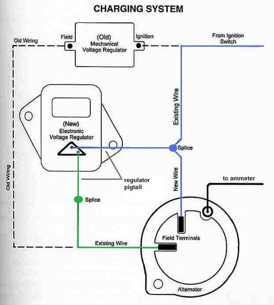

Diagram posted by me is pretty much clear about what do you need for the mod. the one posted by Don Freiler shows the full view. Anything extra is not necesary except if it was a needed mod for any other upgrade still on car

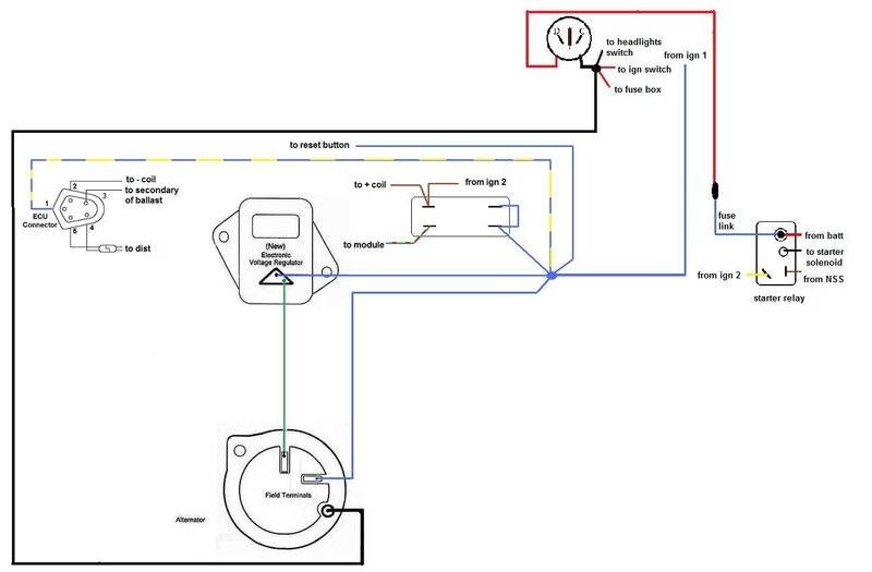

You can peel off a section of the IGN1 circuit previous to the ballast and get the reg, alt field and ECU wire attached there OR... reach the ballast plug, like factory did, then from there up to the regulator like factory did, and THEN THERE splice ECU wire, FIELD WIRE and reg pigtail.
If using stock ECU harness color code ( MP ) the ECU wire to be attached there will be the light blue with yellow trace.
this is for example what Factory made by 1974, where also ANOTHER source for the reset interlock button into the engine bay was added. One common splice down the tape. Also made like this since 72 but without the reset button of course

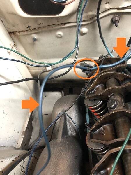

At the end of the blue wire with the packard connector is another packard connector. And yes I am talking about electronic ignition. The first packard connector (the one you circled) was connected to the old style voltage regulator. The second packard connector on the blue wire was connected to the secondary side on the ballast resistor.
Ok, then what the previous owner made is splice the power for the ECU from the regulator plug and must be one of the legs I pointed out?, which is also correct. All those splices are made to share same source from ign switch.
I guess the plug to the ballast also got two wires?
What you can make now? Remove the old regulator plug and terminal, splice/sold on that end the new regulator pigtail AND the wire to alt field along with the existant ECU wire and tape/isolate that splice, then the rest of the harness and you are ready.
