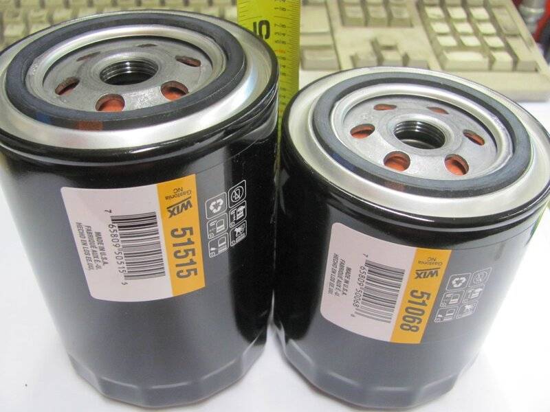

Question. I am being told that the WIX 51515 is the replacement for my matching numbers 1970 383 R/R, when I believe the correct WIX filter is WIX 51068???
Could someone steer me in the right direction?
Thanks for your reply moes.
The Guys down at O'reilly Auto Parts owe me a beer! They are insisting that it is NOT WIX 51515, but the WIX 51068! Honestly. I am not sure of the difference, but there must be!
See the difference. The 51515 has been used on Mopars forever. Use the short one only when you have clearance issues.
When I worked in the auto parts business I believe in the Napa/Wix filter book listed up till 1969 they took the 51515 filter and in 1970 they went to a 51068 filter they are basically the same filter except the 51068 is a little shorter version of a 51515 filter.
I just bought two Wix filters for my 70 383 and the correct number is 51515.
Well thanks guys! And, thanks for the photos as well.
On my way to Safeway to get the beer, and at 100 degrees outside EVERYONE will enjoy!
YES....IN COMPLETE AGREEMENT ..... the shorter version is applicable for later B/RB engines when, I believe circa 1974 or 75 when the accessory drive when the PS pump was moved lower on the block, pethaps to accomodate an emission air pump, and the belt drive passed thru the area, necessitating the use of a shorter oil filter. Use the 51515 filter where possible as it offers more filter area and at a lower pressure drop thru the filter. Just my opinion of course...
