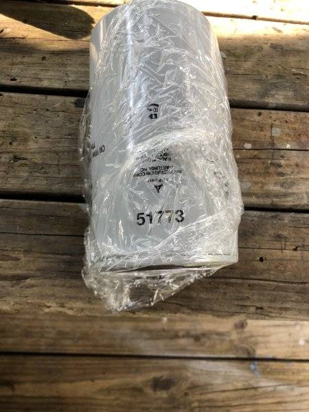

And the racing one is 51515R.
The racing version is great for racing, but not so much for the street. In racing, they're assuming that you'll have fresh oil every race. With its 61 micron size, the R version doesn't filter out small particles as well, but therefore flows better at 28 GPM, while the regular 51515 filters down to 21 microns but flows less at 7-8 GPM.

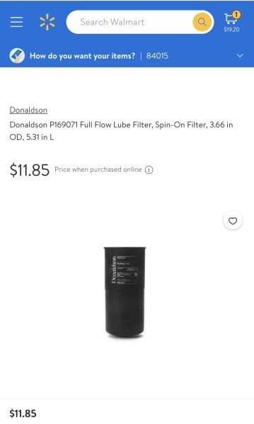

I second the Donaldson filter. I seen it first hand on a fuel filter for my pickup, almost 50% more media than the Wix I pulled out. I can’t remember micron numbers but they were better also.
