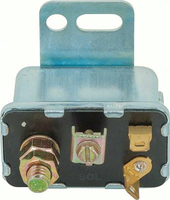

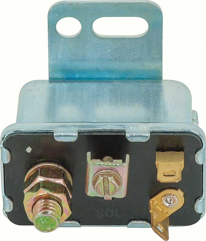

Wait, you said the tranny NSS was plugged off, so dropping the pan is a waste of time. That tranny guy thinks you still have the factory NSS, albeit he thinks it's the wrong one. Did you do as WP said up above and just ground the proper terminal on the starter relay? Let me find a picture of the relay and post it to show you which one to ground...
Here, check it out. The terminal to the top right of the relay in this picture is the ground. Ground that to anywhere on the chassis and that baby should start. The small one on an angle should have a yellow wire to it from ignition. But PLEASE make sure it's in park first!
