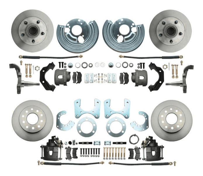

As for as I can tell, he used a kit from Discbrakekit.com. The front dust shield had a part # on it and when I googled it, that's what I found. Now I will have to call them on Monday and see if their parts replace that. Here is one of their cheaper kits.
