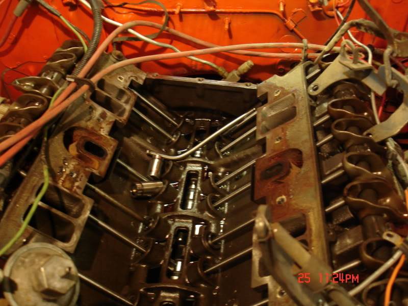

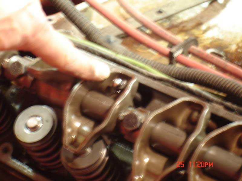

Side tracked,,,,,,,here's a another time:eusa_boohoo:

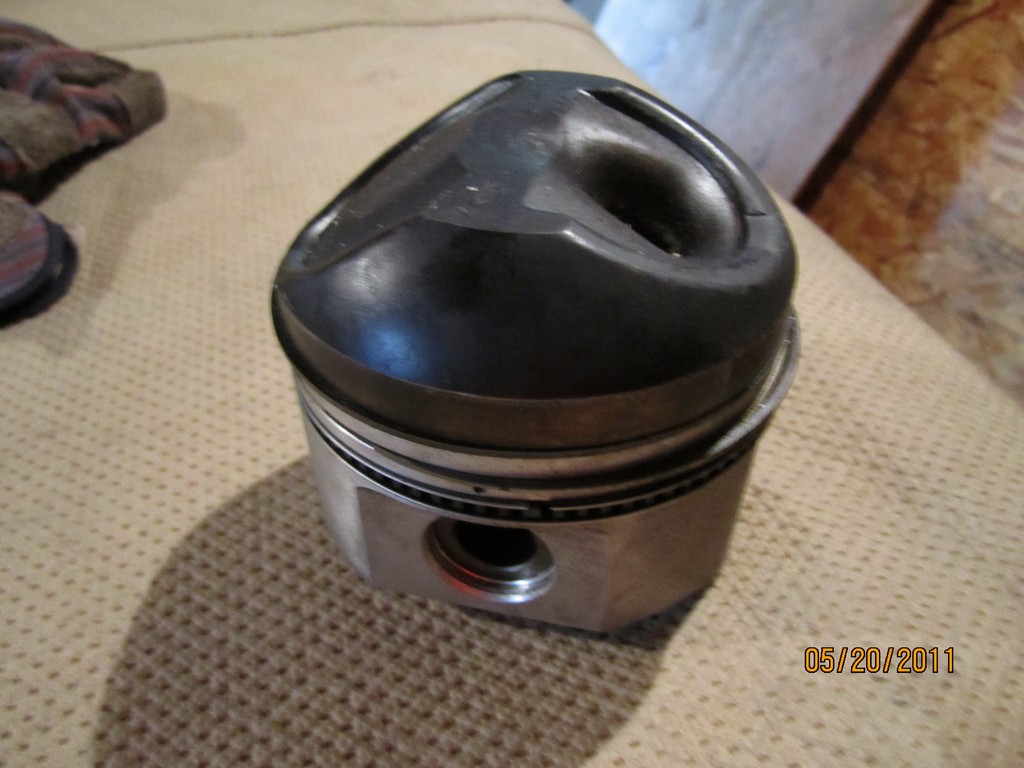

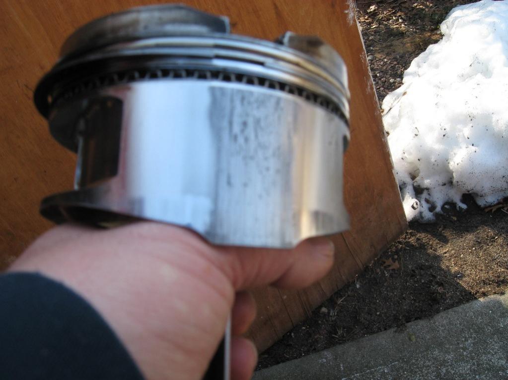

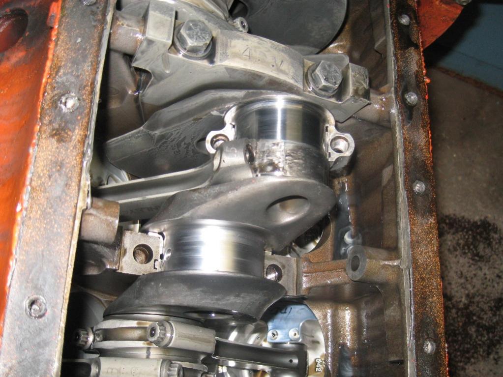

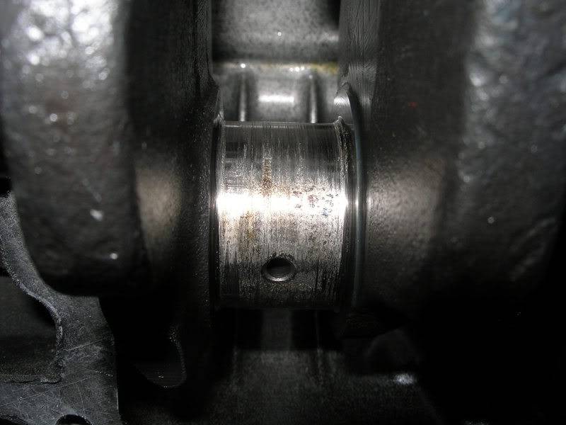

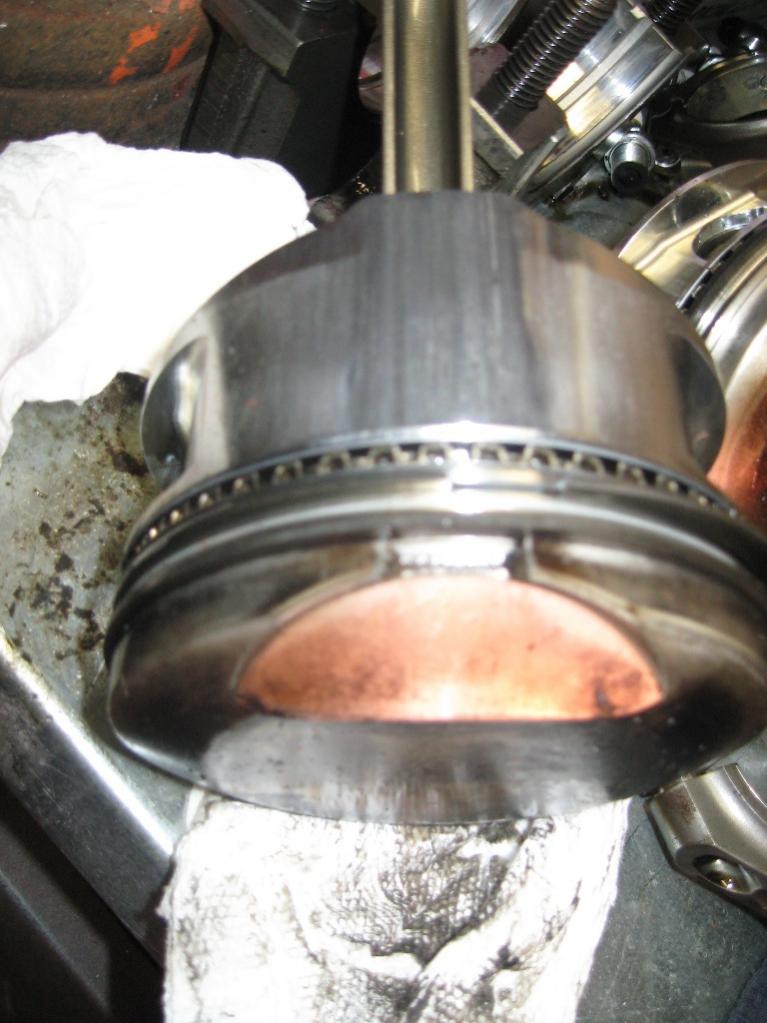

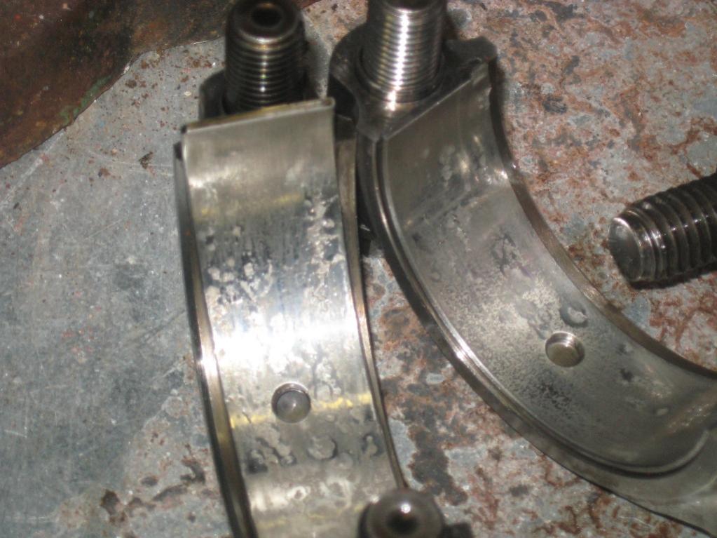

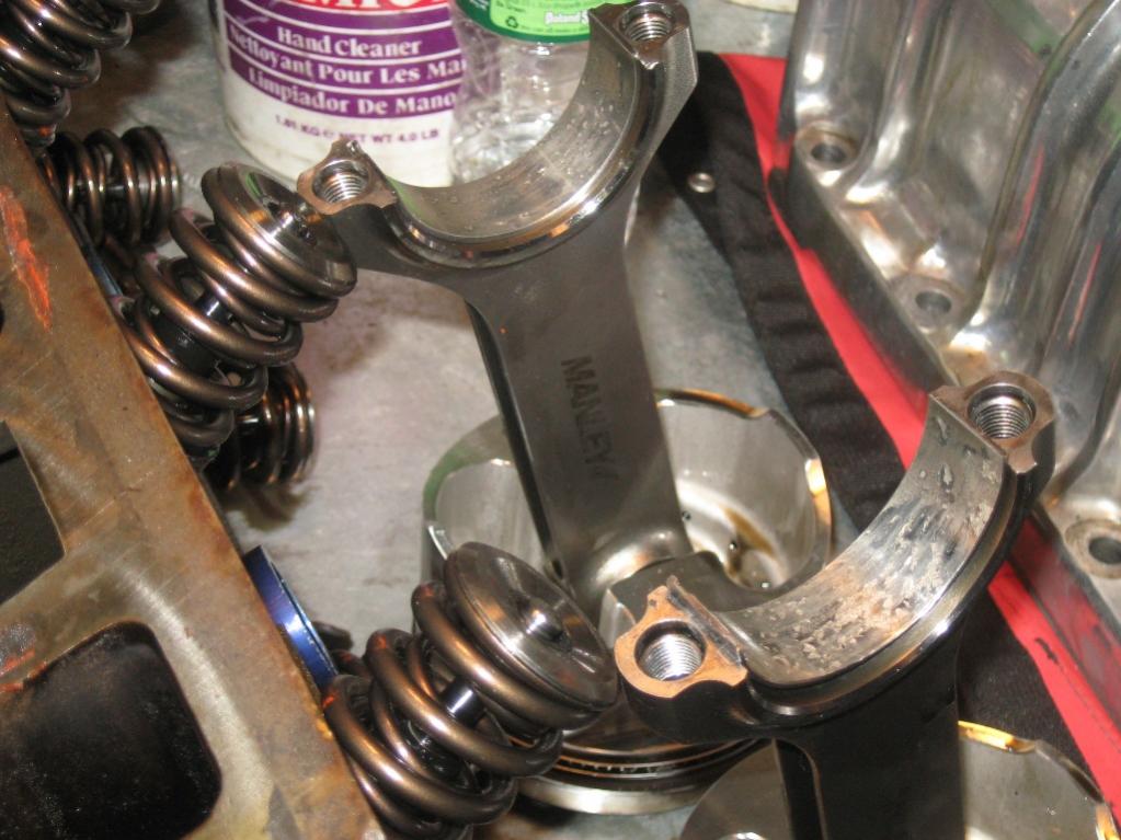

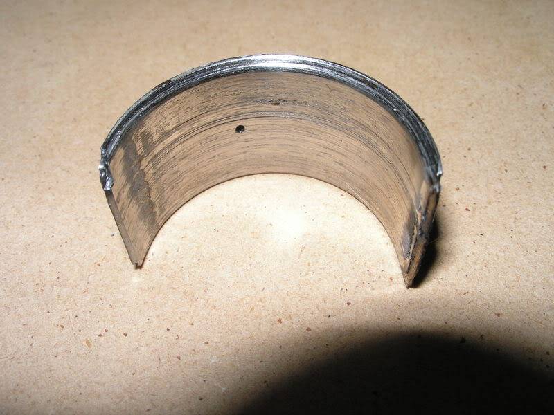

Last round of recent freshen up.Thought I was gunna roll some new bearings & rings in,,,,,,,,,,,,,,WRONG!!Murphy strikes again:eusa_boohoo:

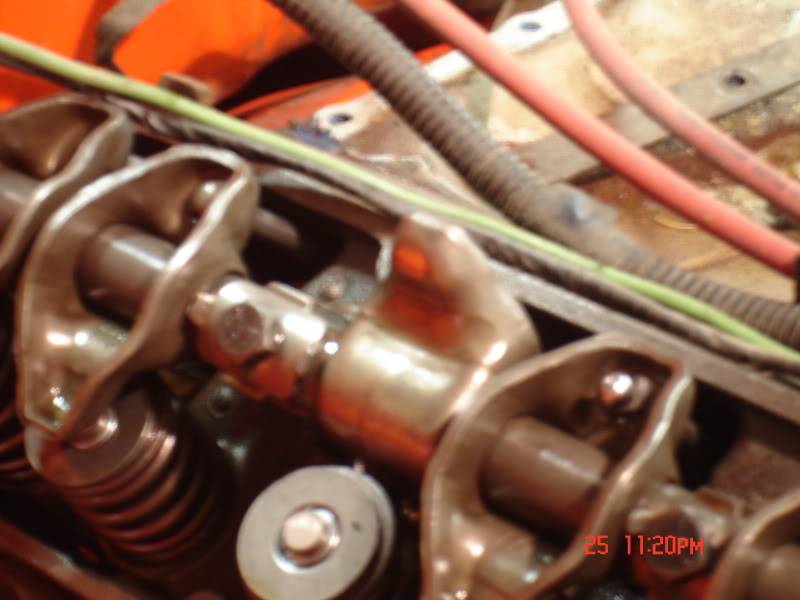

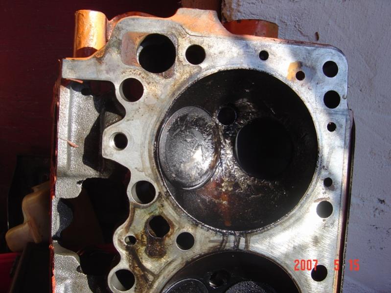

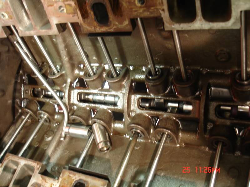

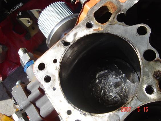

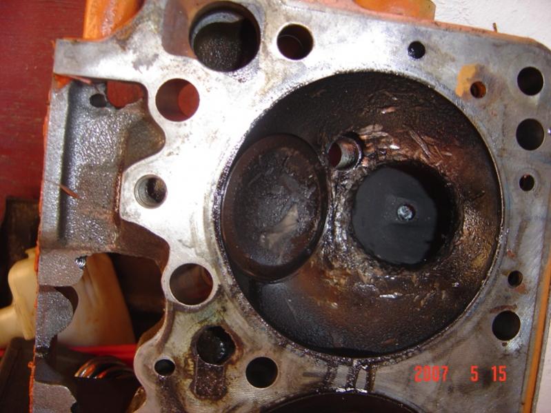

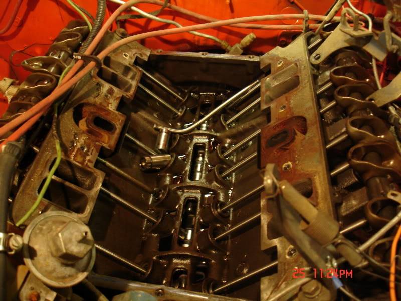

Yes,the blower motor when I took it apart.The reason,,,,,,,,I threw more boost at it than the carbs could handle and detonated.Thank GOD it did not bend a valve on the way out:eusa_boohoo:Answer the problem with a pair of SV1 carbs that Patrick says will handle whatever I can throw at them.Hope to be out this year.
I as lucky on that one.nothing fell into the block.Changed her up to roller top end and carryed on.WHEWWWW.

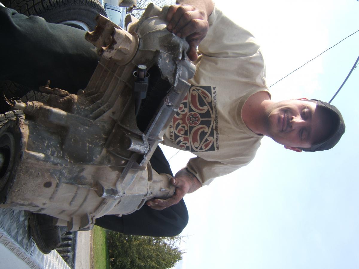

Here's my brother...he toasted his transfer case the other day on his 95 f150 on a pile of rocks. We did the re and re in the grass today in 15 mins...lol

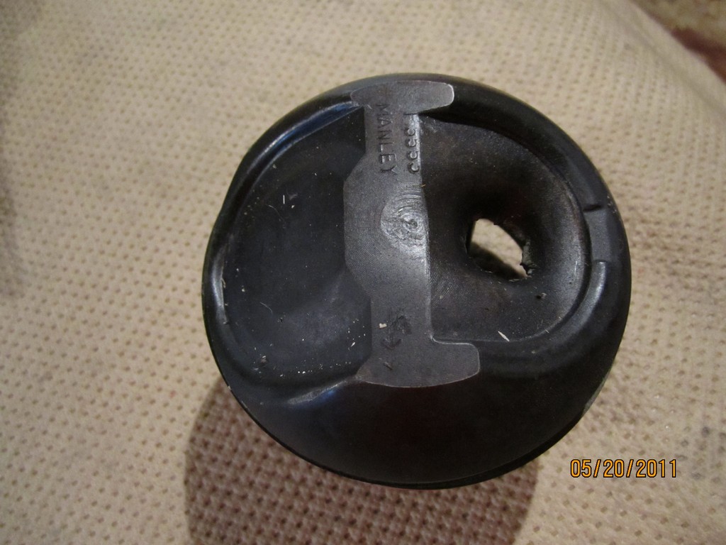

You got me diggin deep into the archives:icon_butt:This is very painfull.Here is what happens when you have alot of cylinder pressure and thin dome pistons.:eek::icon_pai::black_eye::crybaby2::icon_puke_l::sad3:
