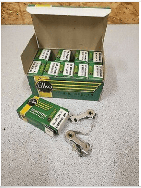

That's the main reason I kept the points systems on my street cars. Got my fill of the factory style electronic stuff that came from the parts houses when the factory stuff from the wrecking yards was drying up....
Yep, I carry a spare points/condensor set, coil and a ballast resistor in each of my cars. Have never needed more than my pocket knife in 40+ years..
