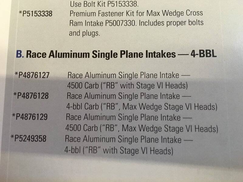

Here are the 4 part numbers for the different stage 6 manifolds:
All of those only fit raised port stage 6 heads(not the “street stage 6”), on RB blocks.
I found this:
https://board.moparts.org/ubbthreads/ubbthreads.php/topics/437387/what-is-this-intake-for.html
Based on the description, it appears to be the P4876129.
MW port, 4500 carb.
If the OP is looking for a 4500 intake to fit MW Victors on an RB, basically....... the three choices are 440-3, 440-3x, SV.
I found this:
MW port, 4500 carb.
