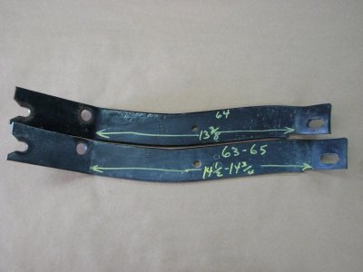

Miller: Checked out both bumpers and brackets this AM. Outer bracket is the culprit. The 64 outer is about 1" shorter than the 63 & 65. I'm going to post an informational set of pics later if I can figure out how to use the wife's camera. Mine bit the dust at the MoPar nats this year. Try to locate a set of 63-65 outer brackets. Least costly path to follow. I've been in the same pickle as you, only the reverse. My 65 had a corroded rear bumper so I bought a rechromed unit for my 65 (actually a 63) and found that the brackets were wrong. Then had to hunt out a set of 63-65 brackets. Someone had put on a bumper assy off of a 64. Probably a body shop.

Miller: Answered your ques about 64 bumper but It didn't take for some reason. 64 rear bumper has been in storage a bunch of years and is really corroded. Wouldn't be a fair swap. Know what you mean about getting wrong parts. Really frustrating. Dug out all the brackets and put both bumpers next to each other. 63, 64, 65 inner brackets all the same. 64 outer bracket about 1" shorter. Still trying to get a set of pics to post.

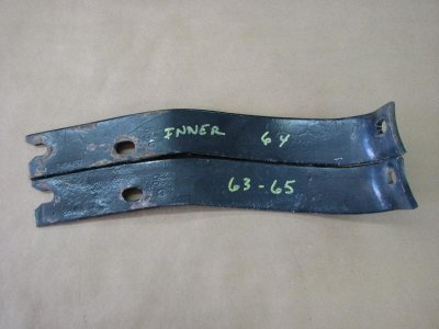

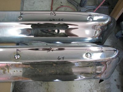

Here are some pics of the brackets & bumpers that show the diff between the years. Note that measurements are to a radius so they are close to about 1/8". Inner bracket for all 3 years appear to be nearly identical minus mfg. tolerances. Outer bracket is about 1" shorter and has a different angle at the chassis mount end. I measured the outer bolt hole off of the end of the concave area at the end of the bumper, just where the concave surface rounds off and ends. Hope this will help anyone searching for a bumper or brackets. Keep in mind that someone selling one or the other may be unaware of the difference so always check. Dimension on outer bolt hole didn't show up very well. 63-65 is 4 1/4, 64 is 5 1/2.
