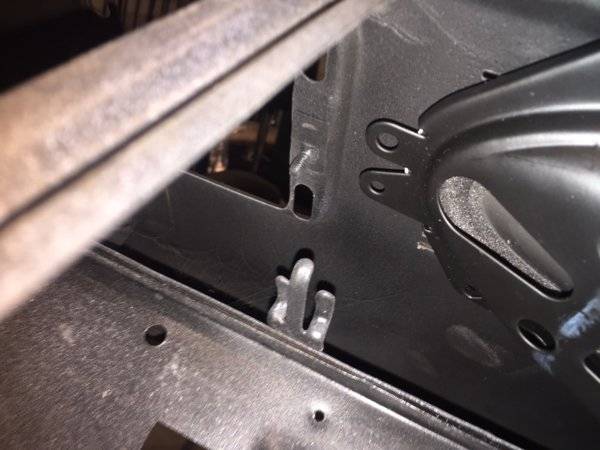

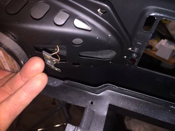

Hummmmmmmmmm, sort of like a square peg into a round hole. Speaker mounting tabs seem to short. Is there a frame the speaker mounts to and then the whole thing mounts to the dash? In one of the pictures you will see one hole is connected, then the other one is to far away.

Long gone, it did not come with the car.

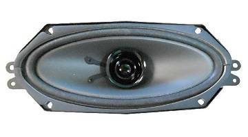

Is that a 4”x 10” spkr?

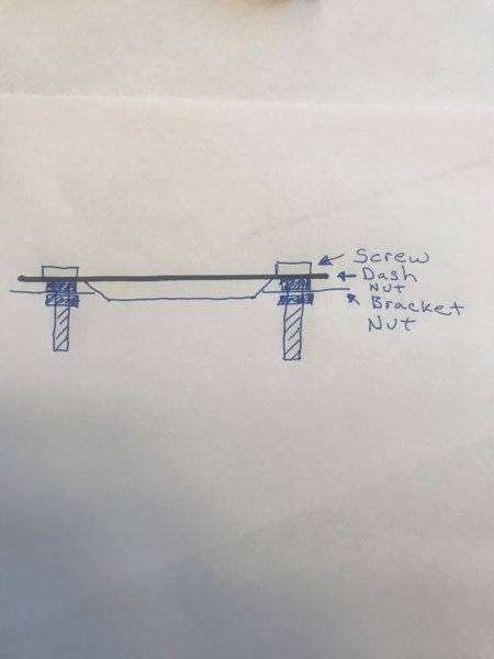

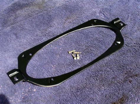

For the new speakers you still use the mounting bracket but you can’t use those tabs for the reason you stated. Go to the hardware store and get 2 screws, 4 nuts and some washers. You may have to file the head of the screw to get the vent in.
G—D—- Chinese junk again?
That is what I was thinking, I thought I saw a bracket in a post awhile ago.......now I have to find one!
