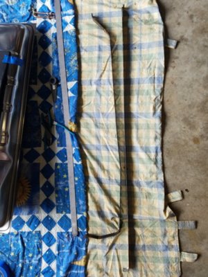

now I am no mopar guru but i have a 69 plymouth satellite and I ordered a pair of stainless tank straps from classic industries and when I went to install the new tank I noticed the straps are not correct. it appears that the new straps have been stamped incorrectly. specifically the end with the 90 degree bend that is facing the opposite direction of the oem part. am I correct?

The tank strap obviously did NOT receive the correct bends....It is perfectly straight, lol....Anyone looking at your photo can see that a mile away.....

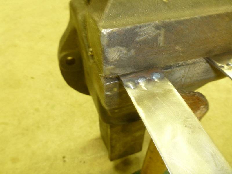

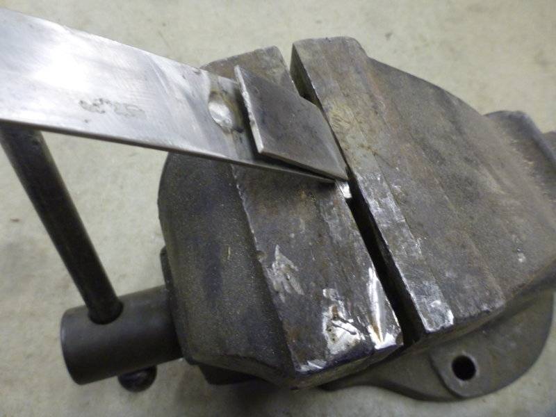

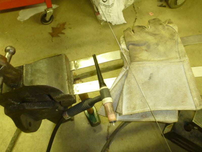

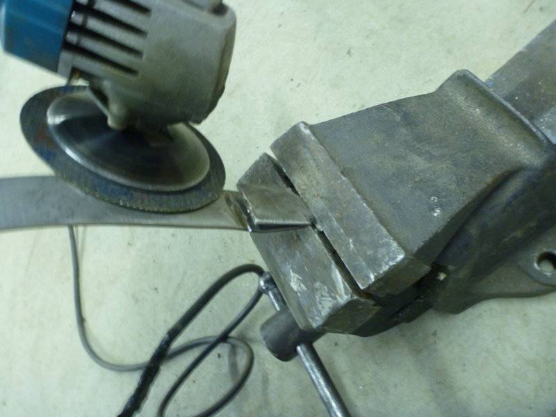

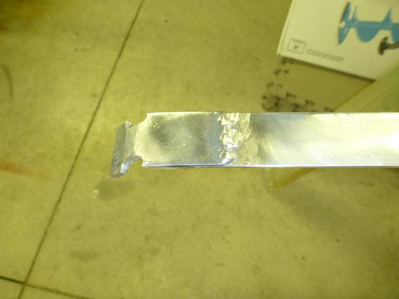

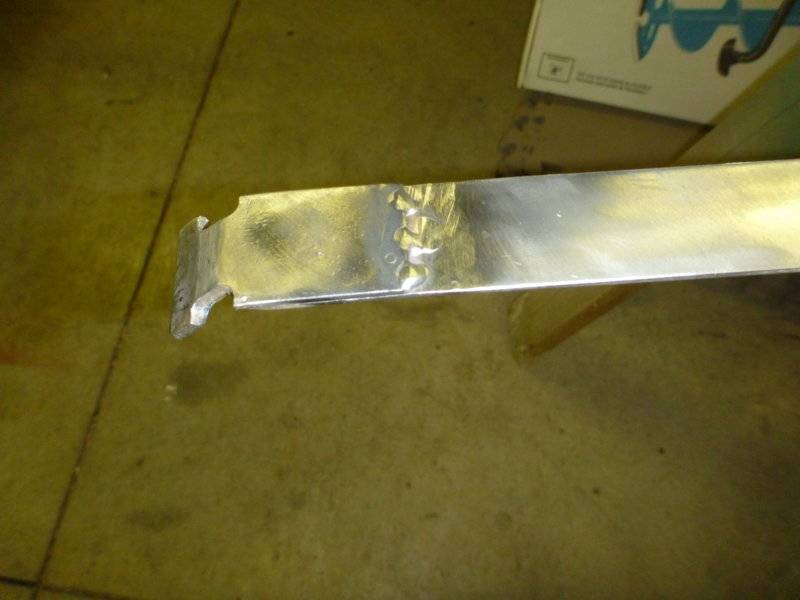

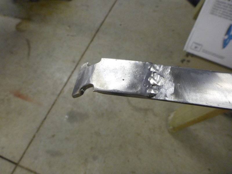

My straps were bent and welded backwards.. had to cut the reinforcements weld, then bend the other way and re-weld.
