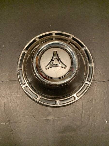

The red stripe dog dishes will not fit your stock 1967 14" rims. These are 1969-1971 caps, and Mopar changed cap size from 10" to 9" in 1968.
Magnum roadwheels were an available option in 67.
These would be the full chrome version with no trim ring.
This is a 65-67 10" Dodge Cap. Used on Coronets and Chargers I believe.

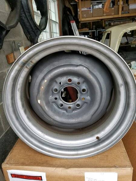

In another post I read the OP bought some new 14" wheels from Coker. I would double check the wheels as I don't remember any company making these wheels to accept a 10" cap. Though there was a member who made the centers. Also don't the wheels that accept the deep 66/67 covers have a different "face" to accept them that has a limited interchange? Which included some C bodies if I remember. I know I had redone a set of 66's but couldn't use them as I didn't have any of the deep face wheels. Just a thought so the OP doesn't end up with a bunch of stuff he can't use.

I bought a set of those 66 hubcaps with the spinner, because I like that look as well. But they won't fit on my 14" steel wheels. Did the steel wheel change from 66 to 67?
No the caps are the same just the center is different.
The steel wheels on the charger had a different deeper outer lip than most of the other ones used at the time.
