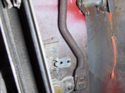

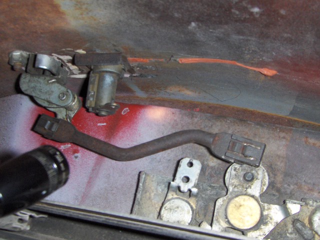

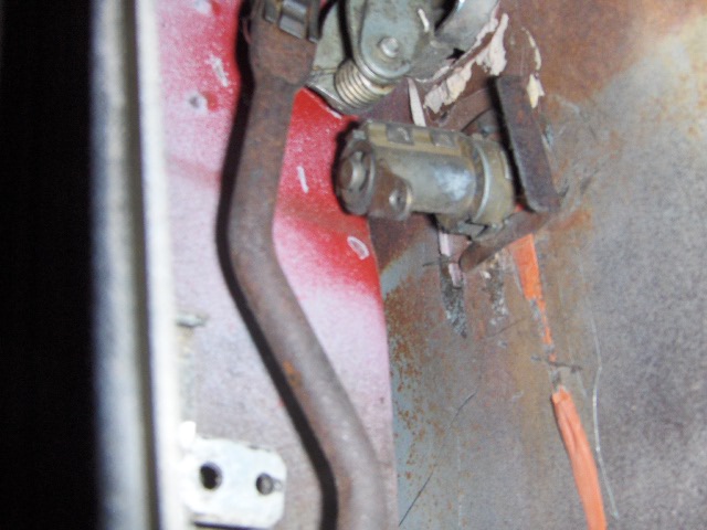

Here is a pic to help identify what is missing. I need to go from the lock cylinder (upper right) to the mechanism (center left)
Need for both doors.
Thanks, Mike

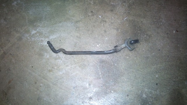

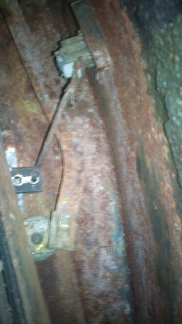

I'm not sure of the interchange compatibility, but I have a pair of them from a 64 dodge. Mine measure 2 3/4 inches from hole to hole. 20 bucks shipped if you think they will work, I will include the clips as well.

I'm pretty sure the ones you found will not work with his door.
You are correct, Dartforforty, those appear to be for the door button, not the locks.

You have a PM on the parts. I included the clips. Look at Brandon's picture about 4 posts above to see how they install. The rod will go in the hole closest to the door skin and the clip will slide on from the door skin side towards the inner door. As Brandon's picture above shows, the clip holes will be visible. The other side pinches the rod to retain it.
