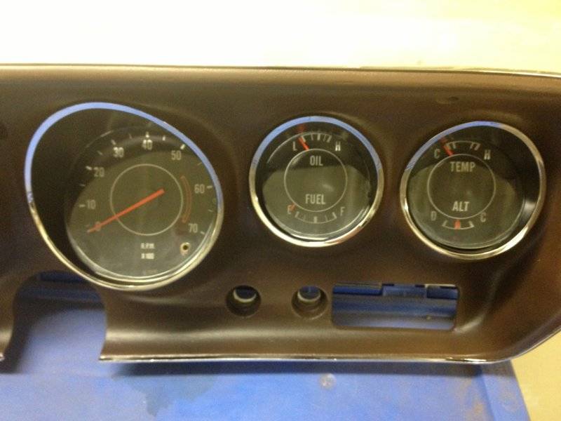

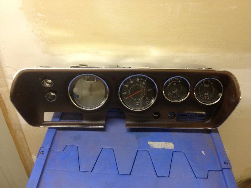

UPDATE: I decided to go with the reproduction tach and the Premium Dash decals listed above. Everything looks great with one exception. My clear lens for the tach has a hole in it for the clock stem. Now I am looking for a solid clear lens for the tach. And after polishing an extra speedometer lens that I had, I discovered it is a different size.
You can use that lens as the factory sent many tach clusters out that just had a clear plug in the clock reset hole.. see if anyone has that little plug..
But! You won’t have the correct reading there then!
I looked at that very carefully before I placed the 7g decal. 0-4g are in the identical positions. Reading 5g now will be about 5250. Not worried about anything higher because the stock valve train will take care that. LOL.

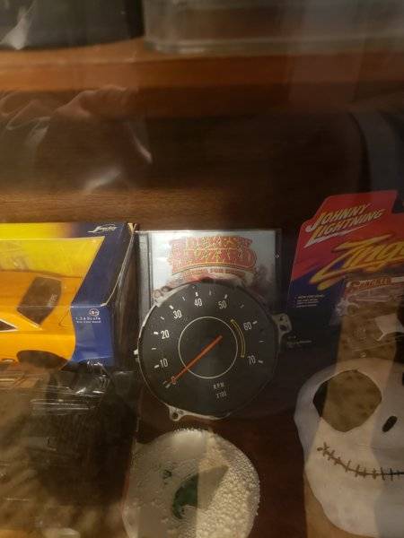

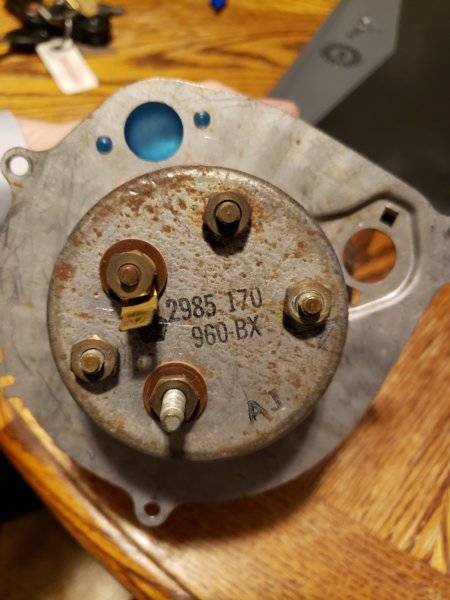

I got an original tach off Ebay for $51. It was represented as a 75-77 Cordoba tach. The part number matched the 71-74 tach part number. I believe it was a mistake on the sellers part. I ordered the upgrade circuit board by rt engineering.
