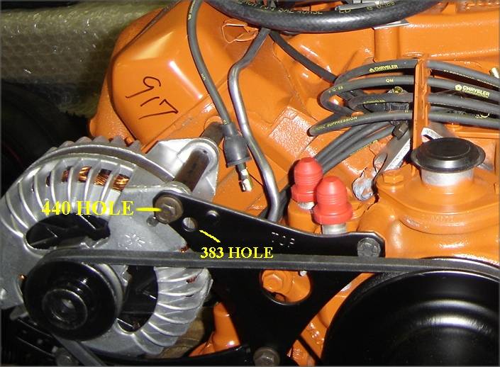

BeepBeep, I hope you got the correct info, the water pump housing you show in post #3 is a '65 & earlier style. The triangle bracket you have is for a '66 & later water pump.
Yea I got the correct info now. Turns out the 67 engine has a 64/66 water pump housing. So I need the longer bracket and different spacers to make everything line up. I'll just buy the kit I found on classic industries site hell its only 30.00
Not saying this is correct but it is the same way I have that bracket on there. This is a 440 with the bracket. Says top on it and shows the holes for 440 application as well as 383. I know its that I have the wrong year brackets but food for though. Maybe others can use it to help them out.
