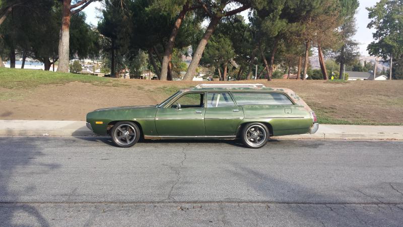

I have a 73 Satellite wagon. The rear springs are toast! The drivers side is visibly sagged upwards on the front section.
